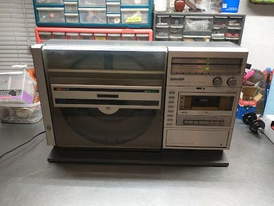

Introduction: Sharp VZ-3000 Record Player Restoration
I picked up this old record player at a garage sale for dirt cheap a while back and tried my hand at refurbishing old electronics.

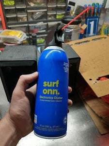

-Surf onn - or any air duster

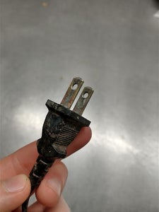

Step 1: Clean Off Power Cords

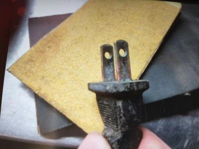

First I sanded down some cruddy residue on the power cord.

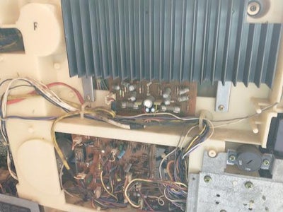

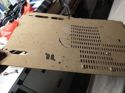

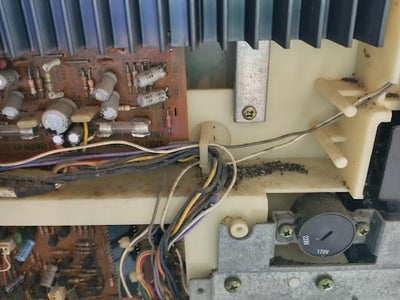

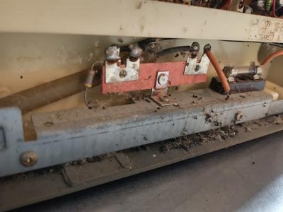

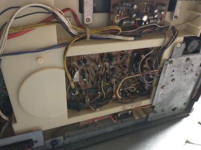

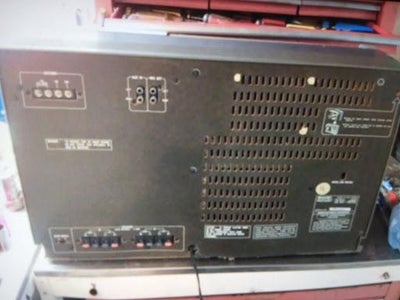

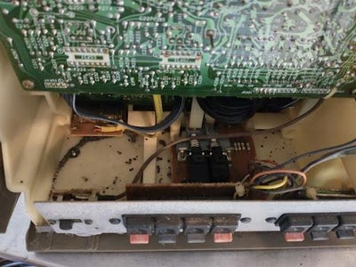

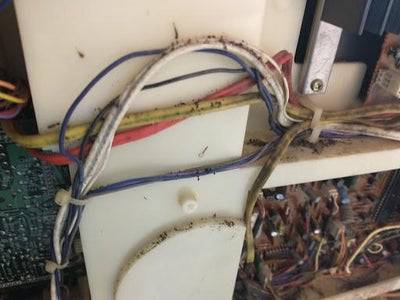

Step 2: Take Off the Back and Clean the Insides

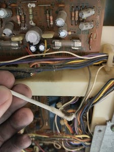

Used the Surf Onn to blow it out and then cleaned it up with a q-tip and alcohol.

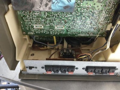

Step 3: Put It Back Together
Just simply put it back together it's not that hard.

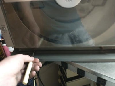

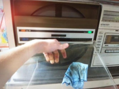

Step 4: Take Off Plastic Covering for Cleaning
Unscrewed the plastic covering and gave the whole thing a nice wipe down

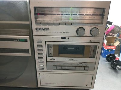

Step 5: Finishing Touches

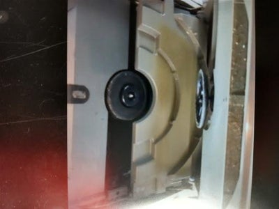

The cassette player wasn't working so I cleaned the heads, pinch roller, and capstan with a q-tip.
Pro tip: Play the cassette and hold the q-tip over the moving parts it's a lot easier than moving it manually.
Step 6: Done... for Now
