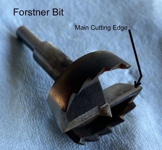

Introduction: Sharpening Jig for Forstner Drill Bits
Save money! Resharpen Dull Forstner Bits

  8. Lock diamond card with top clamp, and press flat blade of a Forstner bit (visible in Photo #3) against it until the shank of the bit rises.
  9. Turn the bit a few degrees clockwise on card, so that full cutting surface is in contact with the abrasive.
  10. Slide end support under the shank, center it left-to-right, and determine whether end support is too high or not high enough. If the latter, use cardboard shims; if too thick, cut a thinner end support. Mark the best location for end support on the base (end of bit directly over center-line).

  2. Use a black permanent marker on cutting surface of Forstner bit that is to be sharpened.
  3. Position bit so that surface to be sharpened is facing down against diamond card, and far end of the bit is resting on the end support below. Push and pull the bit in a "forward/backward" sliding motion, for two strokes. Remove the bit, and inspect the sharpened surface. If only the leading edge is shiny, the end support is too high. If only the leading edge is still black, the end support is too low. Make a new end support that gives the correct results.
