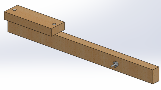

The Help of a Jig...
I've prepared a jig that'll make this easier (Image 2). No need to write an Instructable for this one, yup, it's simply a 300mm baton with a short piece screwed to its end. A wingnut, coach bolt and washer will secure the saw blade to the baton; so you can keep it steady whilst sharpening. When you want to rotate the blade to reach the next tooth, it only takes a flick of the wingnut to release it.
