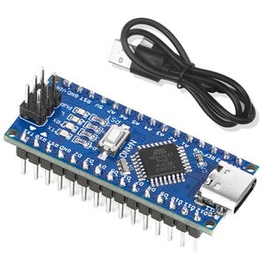

  1. 2 × Arduino Nano (or Nano Every)

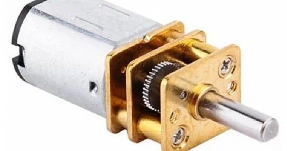

  6. 4 × N20 metal gear motors (e.g., 6V 200–300 RPM for desktop use)
  7. 4 × N20-compatible wheels (rubber tires)

Step 2: Drive and Motors
  1. Mount 4×N20 motors so left pair share a common axis and right pair share the opposite axis to enable skid steering.
  2. Use wheel hubs designed for N20 shafts; add a dab of threadlocker on set screws.
  3. Check freewheel clearance against overcovers; adjust overcover cutouts as needed.
  4. Route motor wires inward to DRV8833 boards on mid-deck.
Why 4-wheel skid-steer? Simple, robust, and evokes tracked rover dynamics at desktop scale while remaining builder-friendly.

  1. Battery → main switch → 5V buck converter → logic rail (Nanos, OLED, servo).
  2. DRV8833 VMOT can take 5–10.8 V; for uniformity, feed ~7.4 V from 2S LiPo to VMOT and 5V to logic (check your driver revision).
  3. Common ground across everything.
Microcontrollers
  1. Nano A: Motion + Servo
  2. Controls both DRV8833 drivers (4 motors) and the servo hand.
  3. Receives Bluetooth serial commands from HC-05.
  4. Nano B: Display
  5. Drives OLED animations (eyes, status icons).
  6. Optional serial input from Nano A for status cues.
Modules and Buses
  1. HC-05 to Nano A via Serial (hardware or SoftwareSerial on pins 10/11).
  2. OLED to Nano B via I2C (A4 SDA, A5 SCL on classic Nano).
  3. Optionally link Nano A TX to Nano B RX for sending simple status chars.

Step 5: Why Two Arduino Nanos?
Separating motion control from display ensures jitter-free PWM for motors/servo while maintaining smooth 30–60 fps OLED eye animations. This improves responsiveness and resembles the subsystem segregation in real exploration systems.
