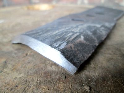

Use an anvil to hammer the blade into the right shape - flattening one side and making it curved.
I didn't have an anvil, but I had some heavy steel profiles hanging around - perfect to use as a kind of 'mold' to hammer the blades into the slight curve I wanted. Very bad blacksmitting, I know. But very effective, nah.

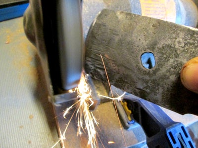

After the shaping I made them nice red again and quenched them in vegetal oil. When the salt melts, it's time to quench. The sisseling of the hot metal was just to die for. And the good smell of fries all over the place even more.
At the end, the blades were set a while in the oven to temper.

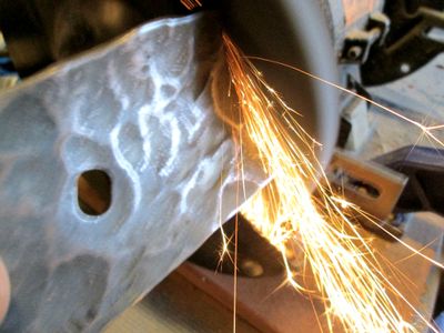

Last action: the sharpening on the grinding wheel.
This type of adze has to be beveled on the outside - contrary to sculpting adzes, where the bevel is on the INside.
30° is the way to go. You ask it, we sharp it. Note the unegal thickness on the cutting edge. Dirty forging, payed cash.

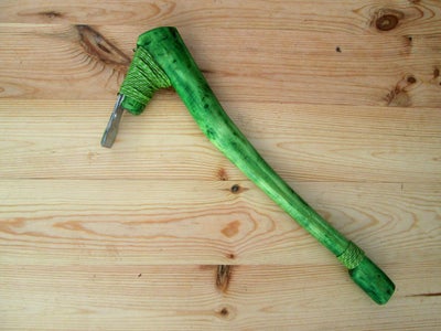

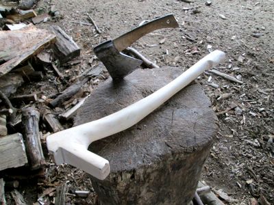

Traditional adzes can be made out of natural forks, natural elbows or just a piece of solid wood.
Instead of setting up a whole database of parameters to find that ultimate form, I decided to get my eyes wide unshut and to let the decision up to the inspiration of the moment. So while I was walking into the valley of the shadow of death, I suddenly found a whole platoon of young cherry trees aka the biggest pooping spot of starlings on earth, I guess.
One had just the fork I needed - the tree, not the starling.
Once cut, it measured 15 inch long and 2 inch thick. No cheap jokes, I'm trying to be serious.
Two inch was right what I needed for that blade I forged the day before.

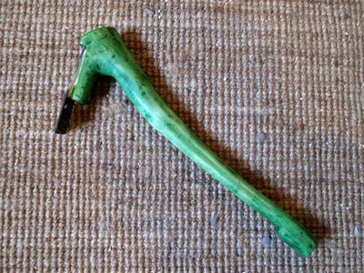

Some debarking, rough shaping with axe & knife and drying. Greatful I felt, that day.
Step 4: Better Than Porn
Besides porn, you can also find useful knowledge on the net.
I learned, for example, that a good adze design is based on a few geometrical parameters. I highly recommend to have a look at the site of the Jayhawk Institute. It must be the first site of which I read every word. Twice.
Like shown in the first picture, the blade edge needs to make a 90° angle to the top of the hand holding the tool. The adze will pivot from this point, and respecting this rule will make it a good cutting tool. I can't tell you if it's true, but untill proven false I'm ready to believe it.
This doesn't mean you need to cut the excess at this point, it means you need to cut it about two or three inches above it (red dashed line).

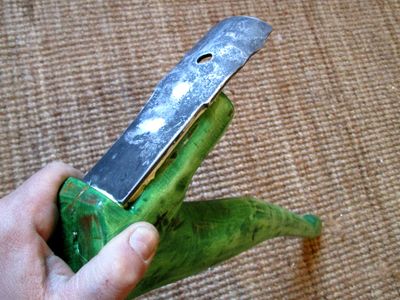

Once the short side is cut right, you need to cut a 'shoulder'. This prevents the blade from moving backwards while eating the chips out of the trunk.
Finally, at the downside of the short side you need to remove some stuff because that's where the cord will be attached.
Let it dry a bit more, and finish it to its final design. All tools alowed.
Don't sand it too smooth. Real cavemen like it rough.

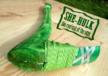

This thousands or years old tool would become The Famous She-Hulks Hallux.

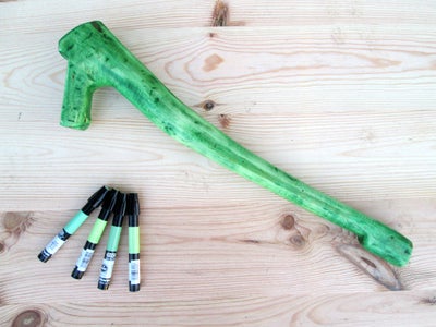

Before I asked my wife to set free her wildest fantasy on my tool (never thought I would ever write this one), I coloured the wooden handle with green colorant. I intended to do it like this, but since I couldn't find the green coloring I used a magic toxic marker.
Of course it works.

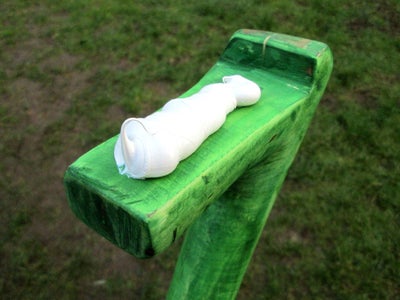

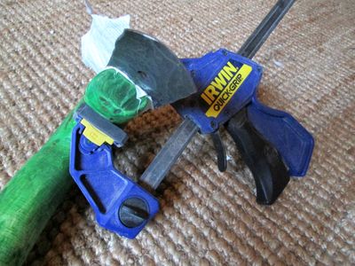

Then I fixed the 'nail' to the 'toe'. Yes I used magic toxic glue, yes the authenticity of whole project became contaminated, but don't you think it already was from the moment I coloured it green? Advantage: the glue filled the slightly uneven contact zone between the shoulder wood & the blade.
Craftmanship is in the details, always.

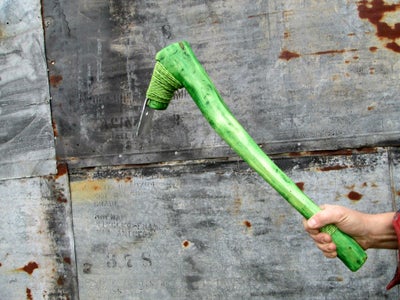

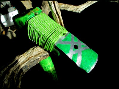

Ten meter of flashy green paracord & a well tighted fishermens knot finished the fixing - don't underestimate the length you'll need.
Rock solid, ready to dig.
Finally my wife let the beast go, taking this cavemens invention to a whole new level.
She chose a sober & stylish nail art. On a cave-tool.
