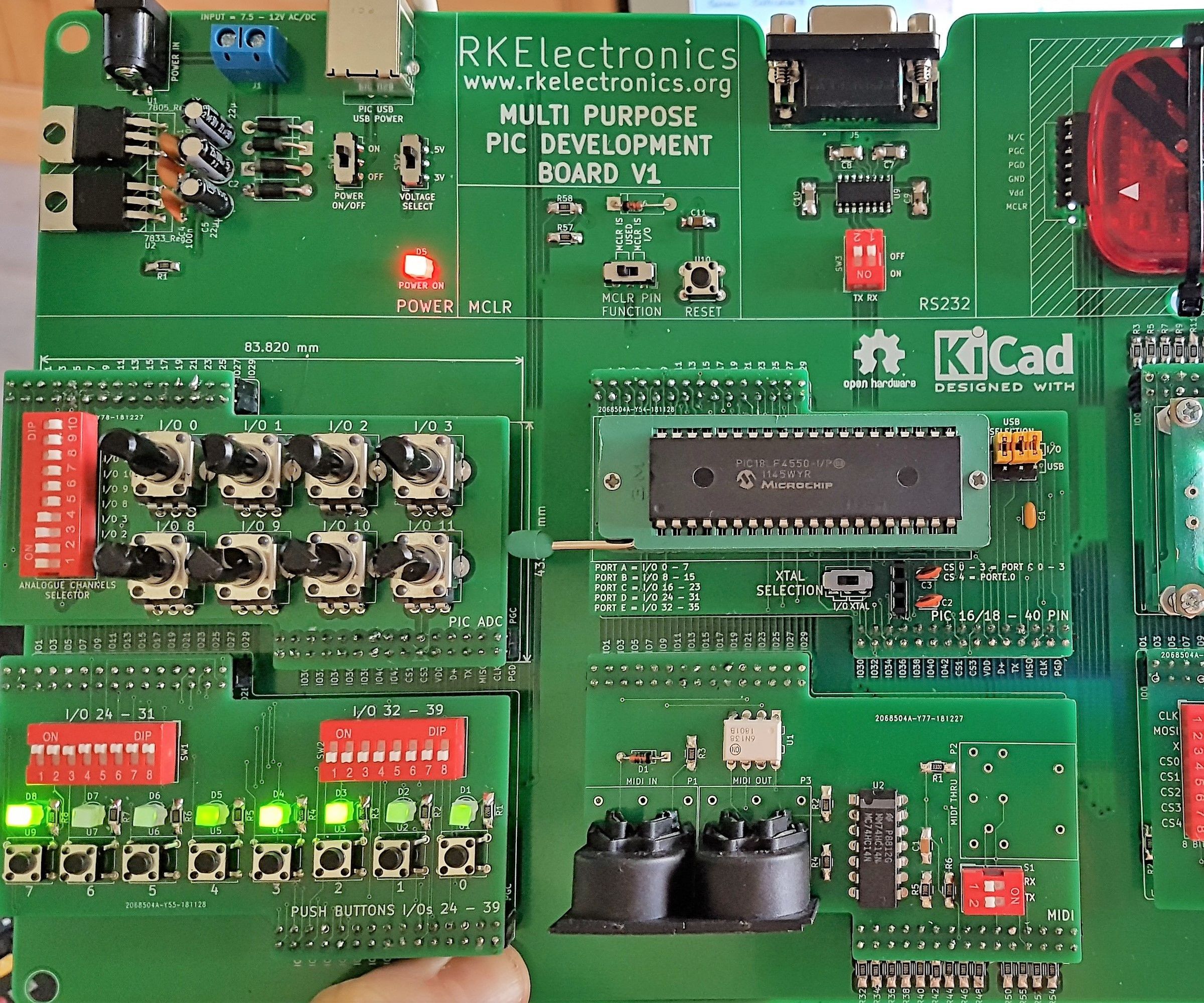

This project is for an alarm unit which will sound a siren in the event of an unexpected intrusion into a shed or log cabin. The alarm arming will be made by key switch. There will be a ten second delay between key activation and the alarm arming. A ten second delay will also be present between intruder detection and the siren sounding to allow for a suitable time for genuine alarm deactivation. Intruder detection will be via two methods; magnetic door switch and an infrared motion detector.
The alarm will consist of two units; the internal control unit (with key activation for the alarm) and a second for the outside which will contain the siren, siren control circuit and backup battery.
Both the alarm control box and the outside bell box will have a tamper detection switch which will activate the siren upon the enclosures being opened.
The alarm system (internal control unit) will display the alarm status and the current time (clock). There will be an electronic menu for setting the time, testing the siren and setting up a maintenance mode which will allow the enclosures to be opened. The menu will only be available when the alarm is deactivated.
Attached project folder contains the schematic diagrams, project documentation and HEX files for the PIC microcontrollers.
