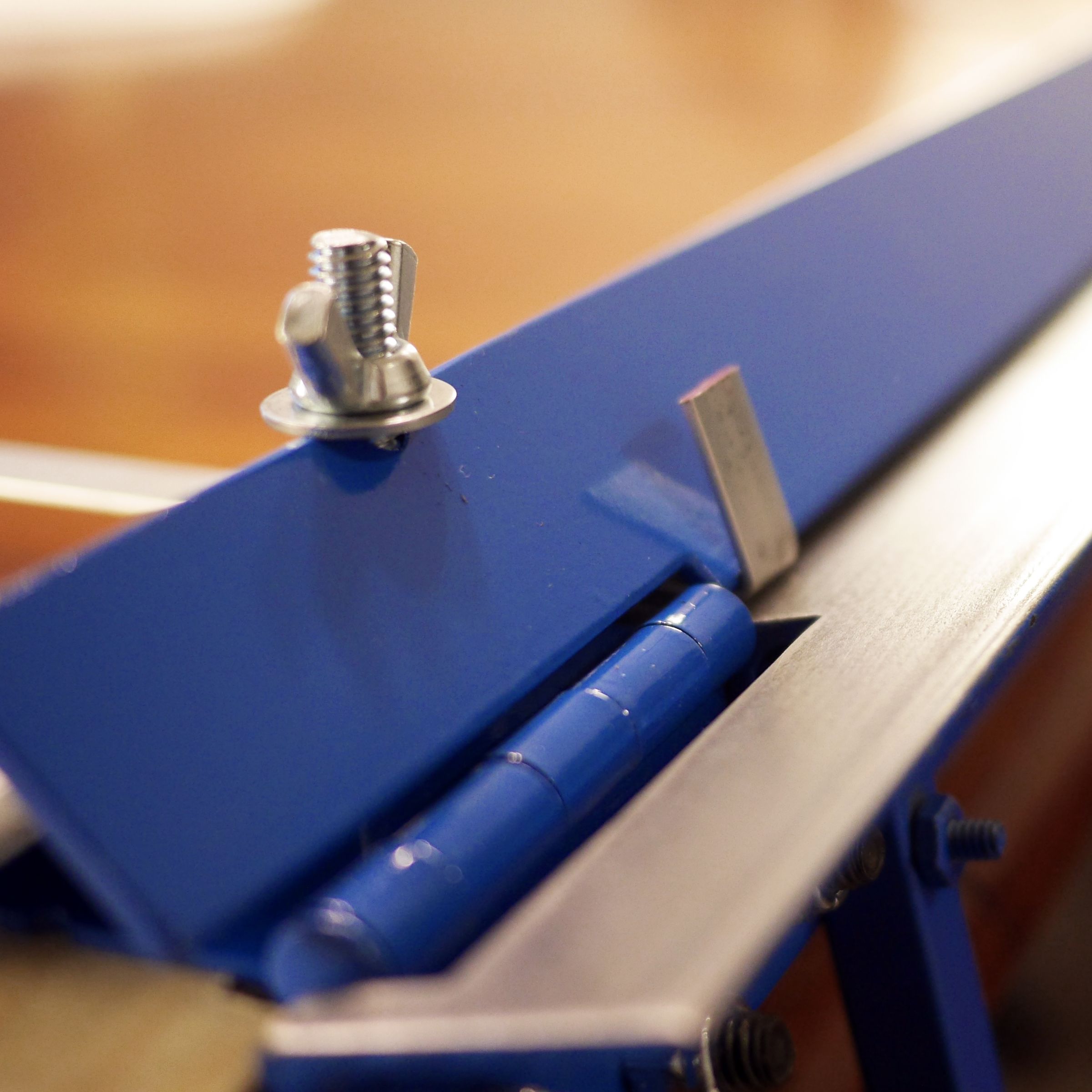

Sheet Metal Brake
Here's a great instructable detailing how you can make your own sheet metal brake with a steel angle, some door hinges, and a piece of lumber: https://www.instructables.com/id/Simple-Sheet-Metal-Brake-No-Welding/

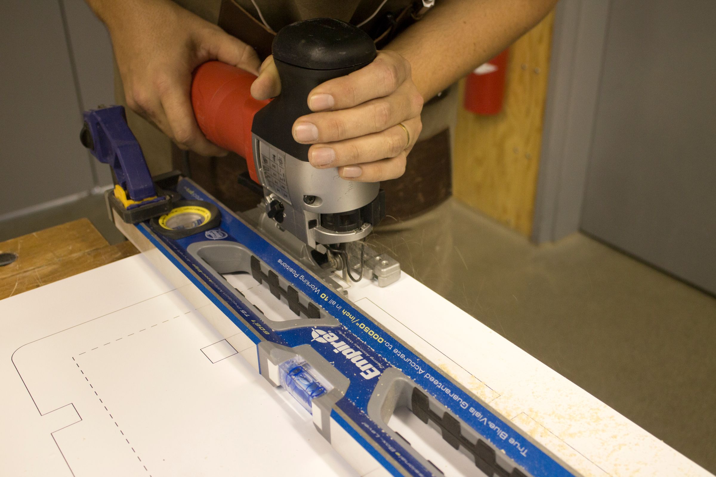

If you don't have a water jet (come on, get with the program), all you need is a hand drill, a jigsaw with a metal cutting blade, a large format print from a print shop, and some patience. Here's a link to my Digital Fabrication by Hand instructable, showing you how to be your own CNC machine: https://www.instructables.com/id/Digital-Fabrication-By-Hand/

I used 16 gauge stainless steel for the enclosure, and 8 gauge stainless steel for the platform and feet. Stainless steel is really hard to brake, so I added perforations to make it easier.
I would recommend using light gauge mild steel (16 gauge or less) for the whole project if you don't have access to a manufactured sheet metal brake.

The .dxf files are the individual layout parts that you can use if you have some kind of CNC to to the work for you.
The .pdf file is a 48" X 48" sized layout with all the parts on it to scale. To print this out and use it as a template, bring it to a print shop that does large format printing and tell them to print it at full scale / 100% / original size / no scaling on a 48" wide (or larger) roll.

With the parts water jet and de-burred, I moved on to the sheet metal brake. The folds all have specific angles they need to be, but since our brake doesn't have an angle gauge, I just eyeballed it. I figured that since the sides were going to be riveted together, I could just use vice grips to take the stress off the rivets and bend them into place by hand.
