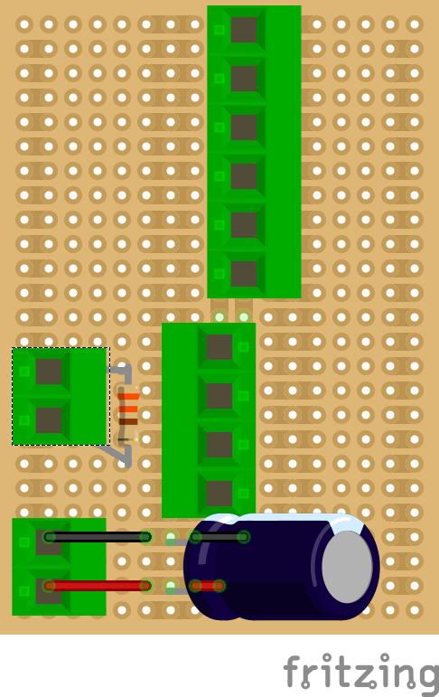

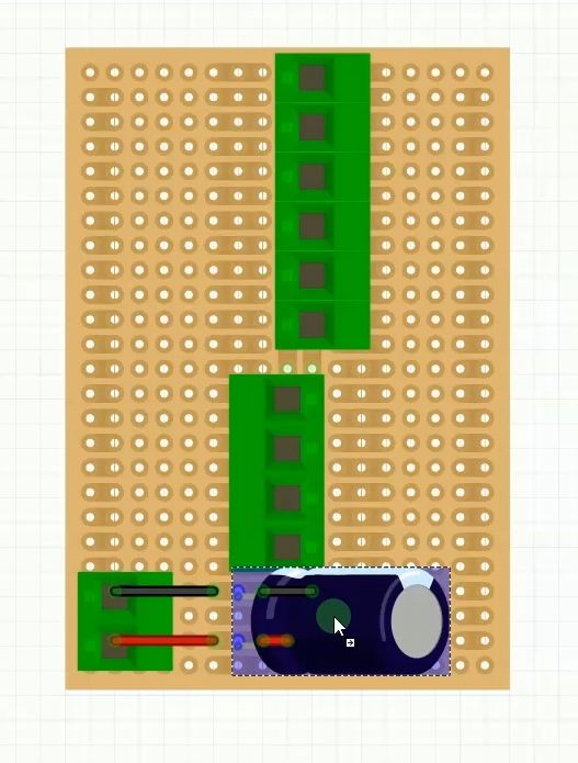

So the first thing we are going to do is build or after main power power supply for the project.

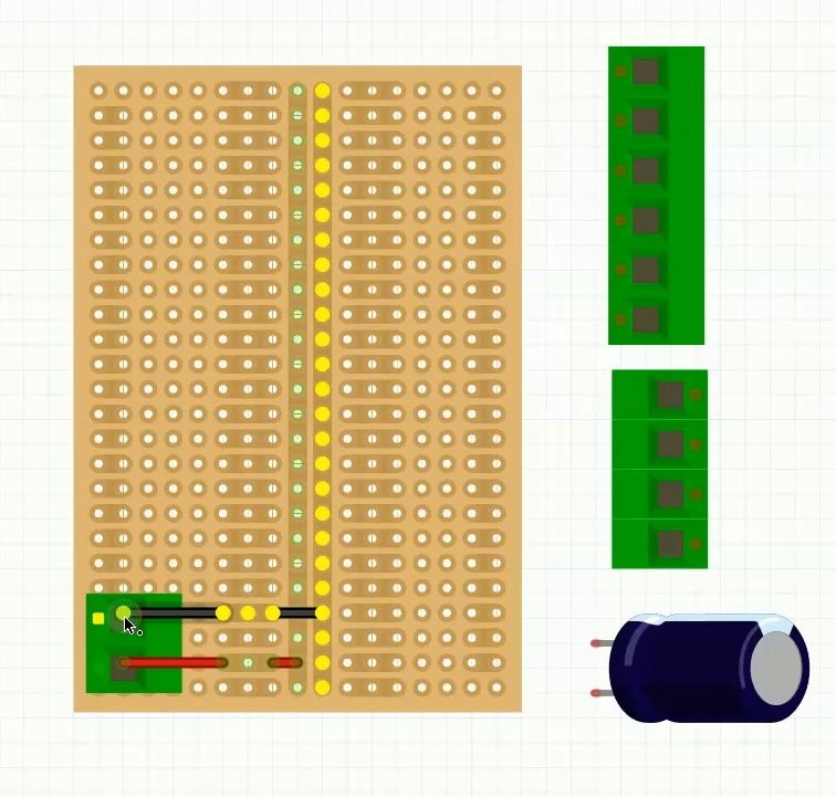

Again I kind of lucked out with what I had laying around but the mounting holes on this breadboard ended up lining up perfectly with the holes on my arduino case. You can watch the video or follow along below for how to build this piece. The only thing the video doesnt cover is the resistor.

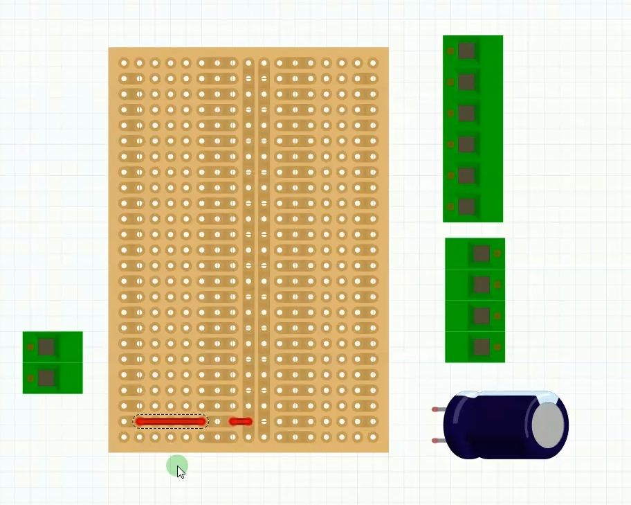

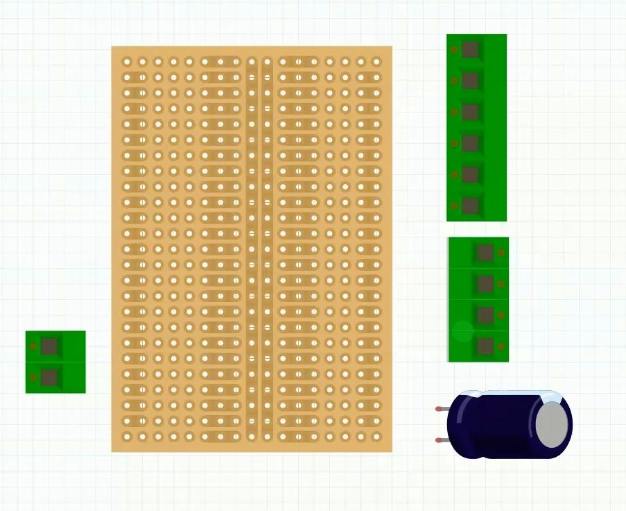

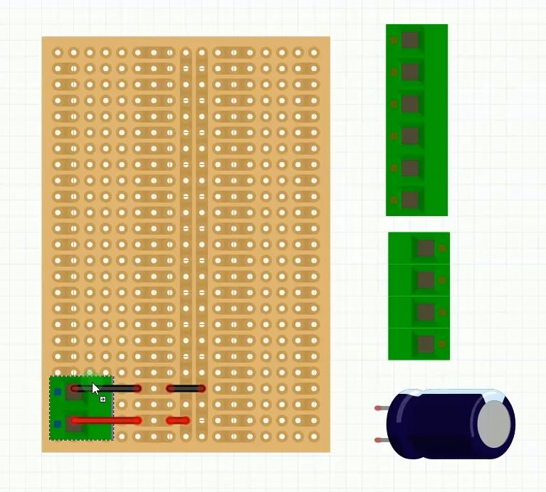

- First lets gather the materials. The breadboard, screw terminals, wire, and capacitor.

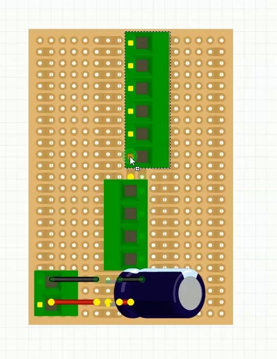

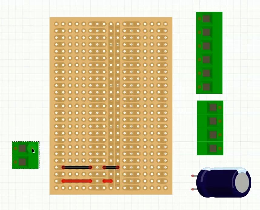

- Next we need to connect the a few wires from the common power rail in the center to the outside. Keep in mind these wires should be inserted from the bottom for clearance.
- Make sure that the wire on the outside is cut off just enough so it doesnt go all the way through. Enough to be in the hole but not enought to fully protrude.
- Now we need to do the same thing for the ground common rail. Keep in mind these wires should be inserted from the bottom for clearance.

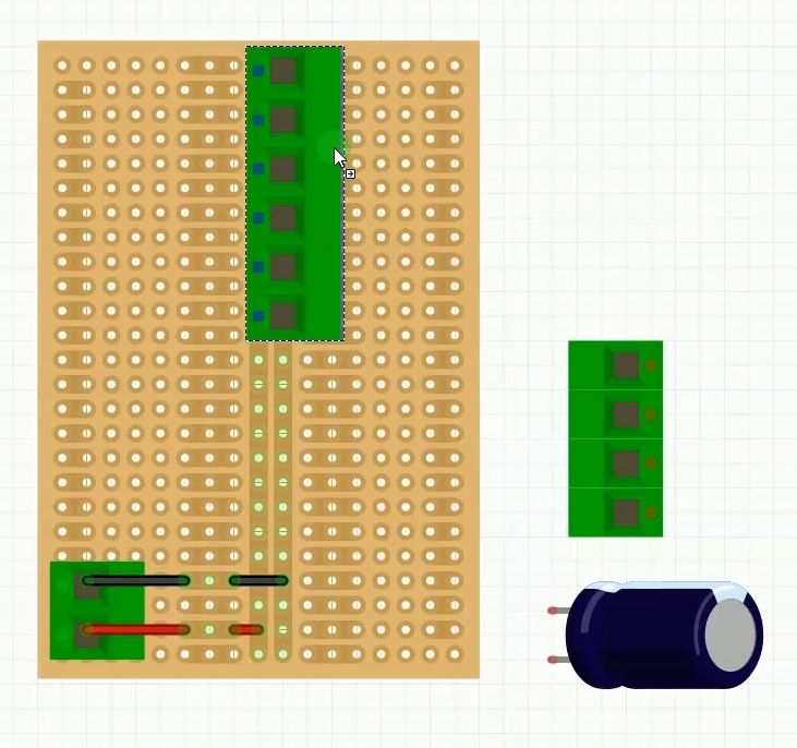

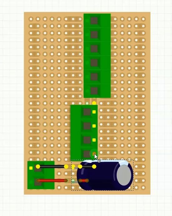

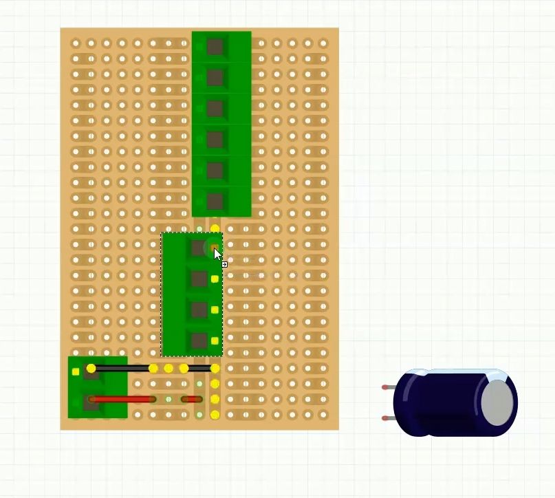

- Next we can bring over our small screw terminal
- Notice how both the Postive and Negative Rails will light up to show they are connected when you click on either of them.

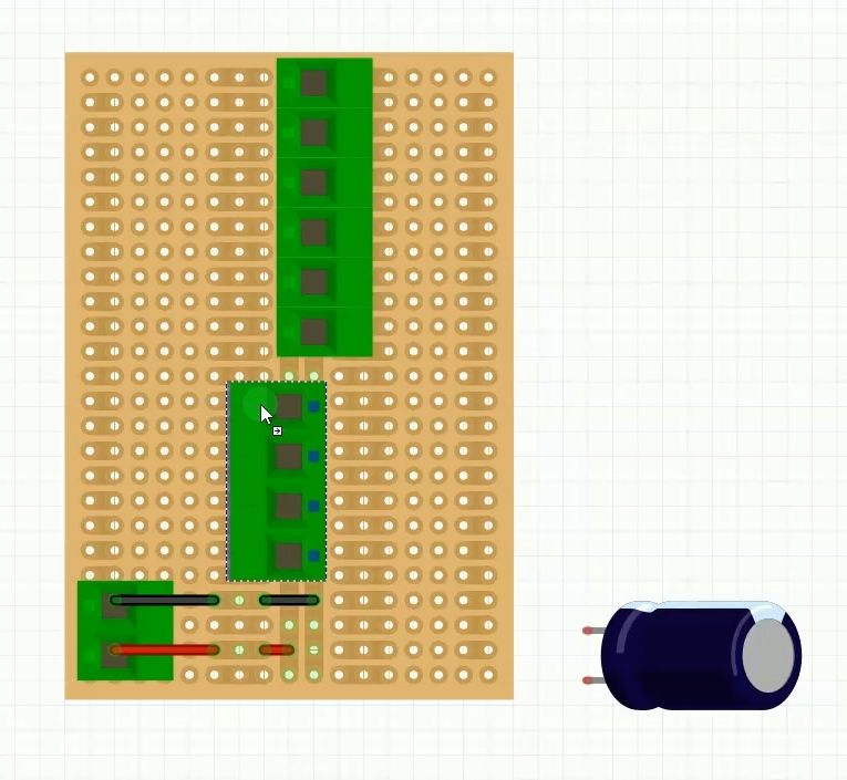

- Now we can bring over the large section of the screw terminals to the positive rail.
- Again notice how everything lights up to show connection when you click on the terminal
- Now bring over the smaller screw terminal and put it in the negative/ground rail.
- Same thing occurs when clicking on one of the terminals to show connection
- Now we can bring over our capacitor, make sure the negative lead goes into the negative spot.
- Again we can check connection on both the positive and negative rail.

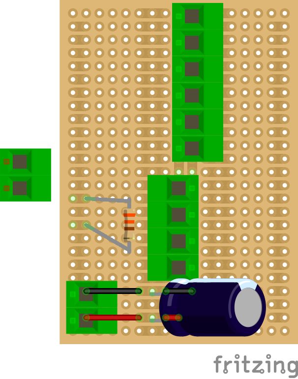

- Additonally Adafruit recommends a resistor on the data line, so we took another screw terminal and a 330ohm resistor and jumped between the two pins on the terminal.
- First the resistor
- Now the screw terminal.
- Now that everything is on the board we need to flip it over and start soldering everything on. Once this is done. We can move on to the next step.

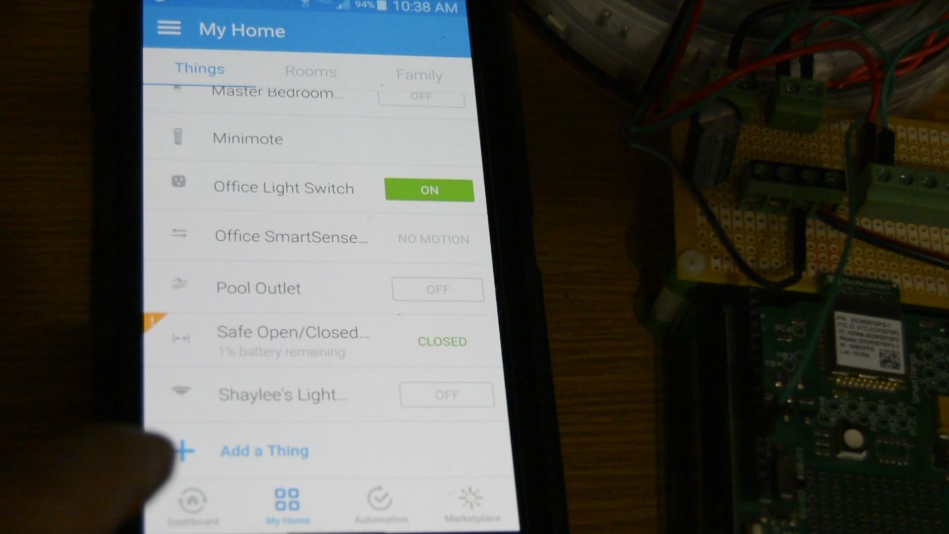

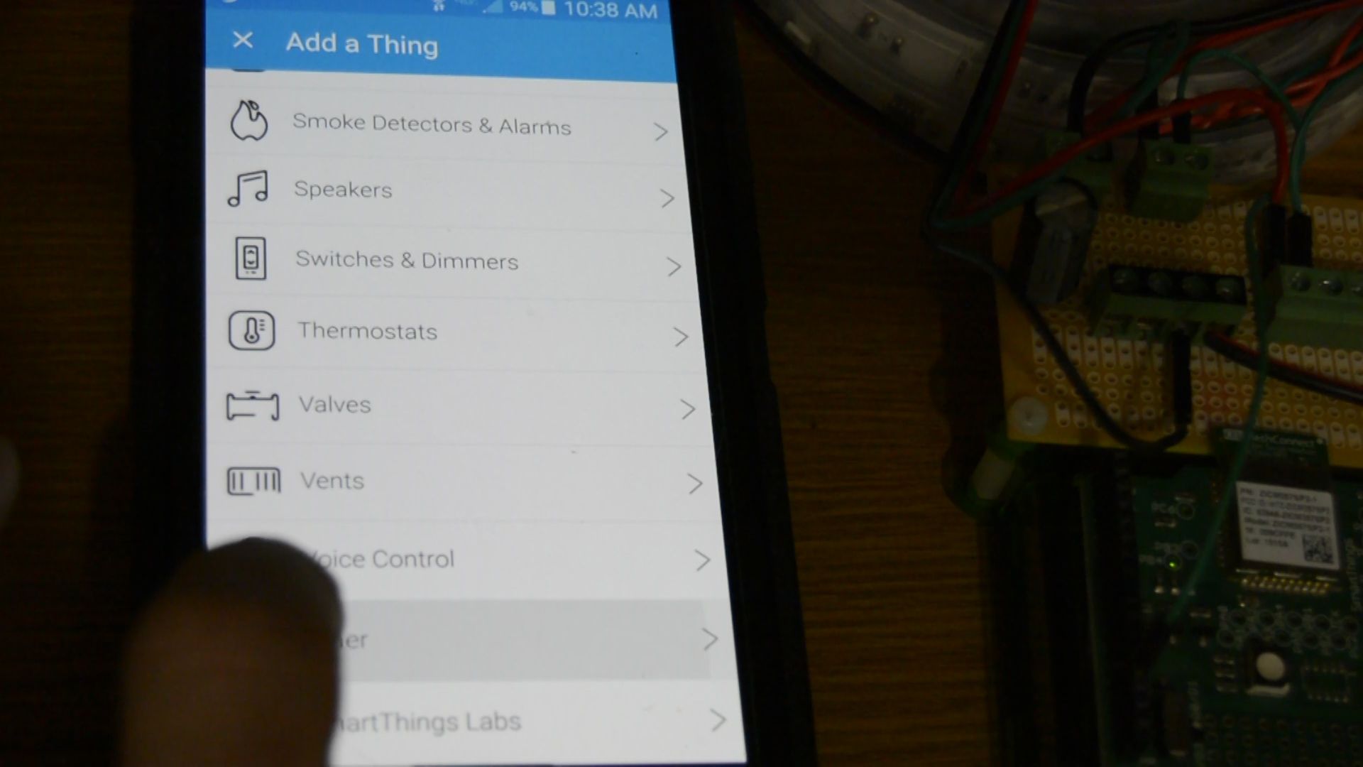

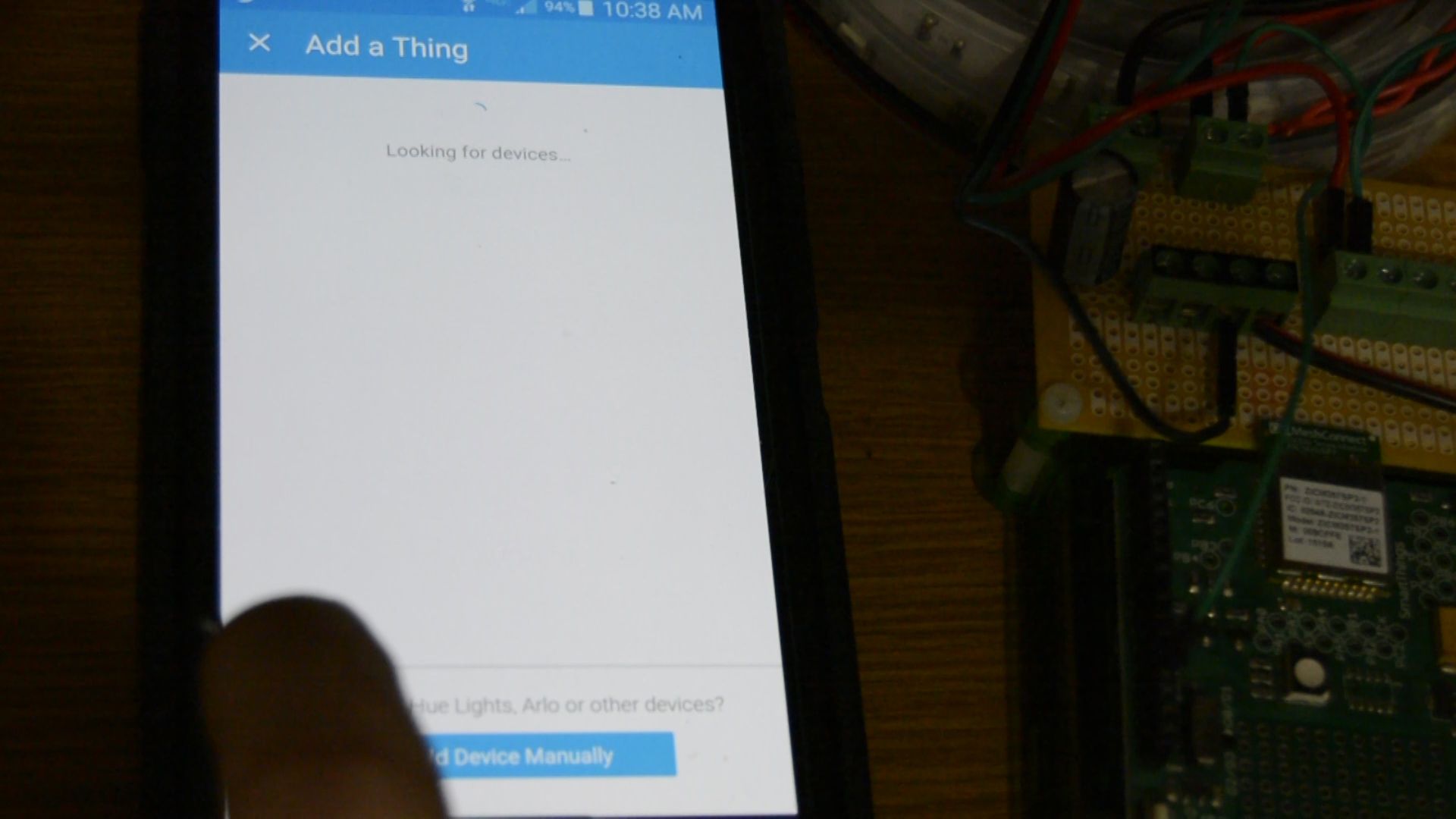

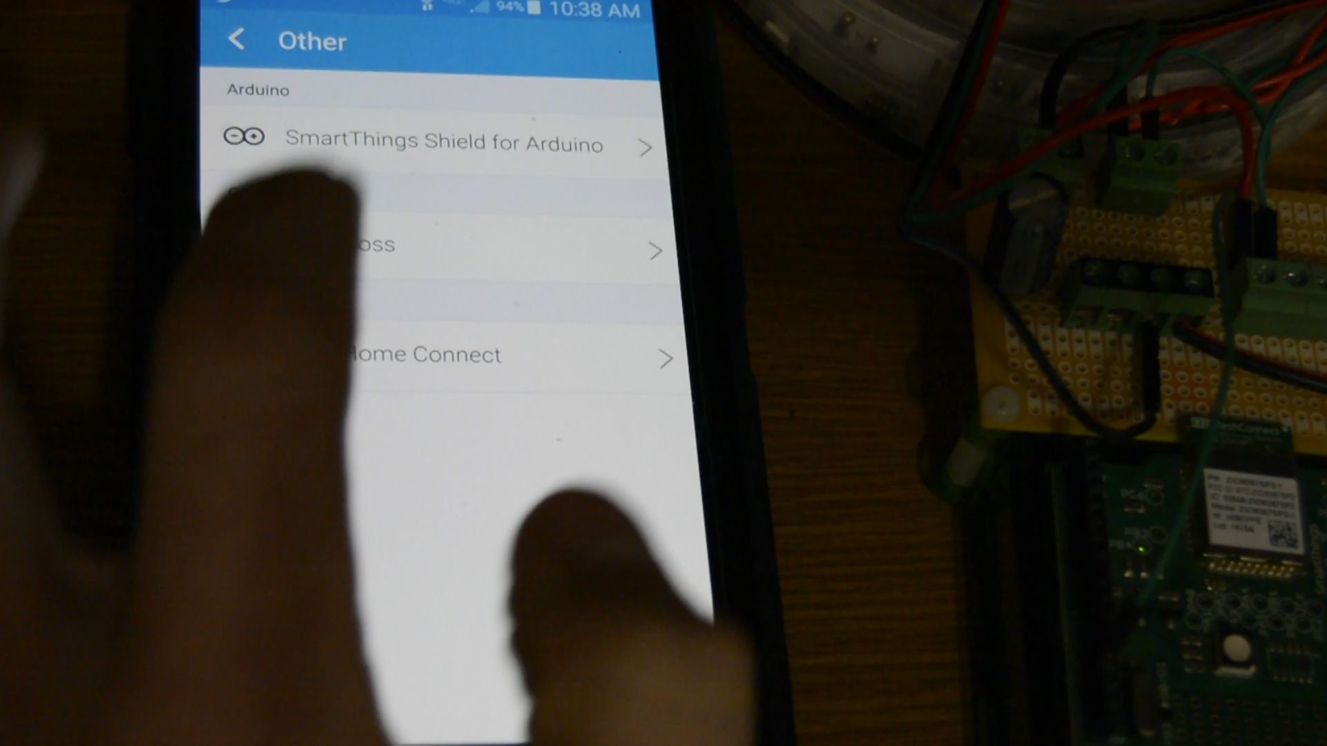

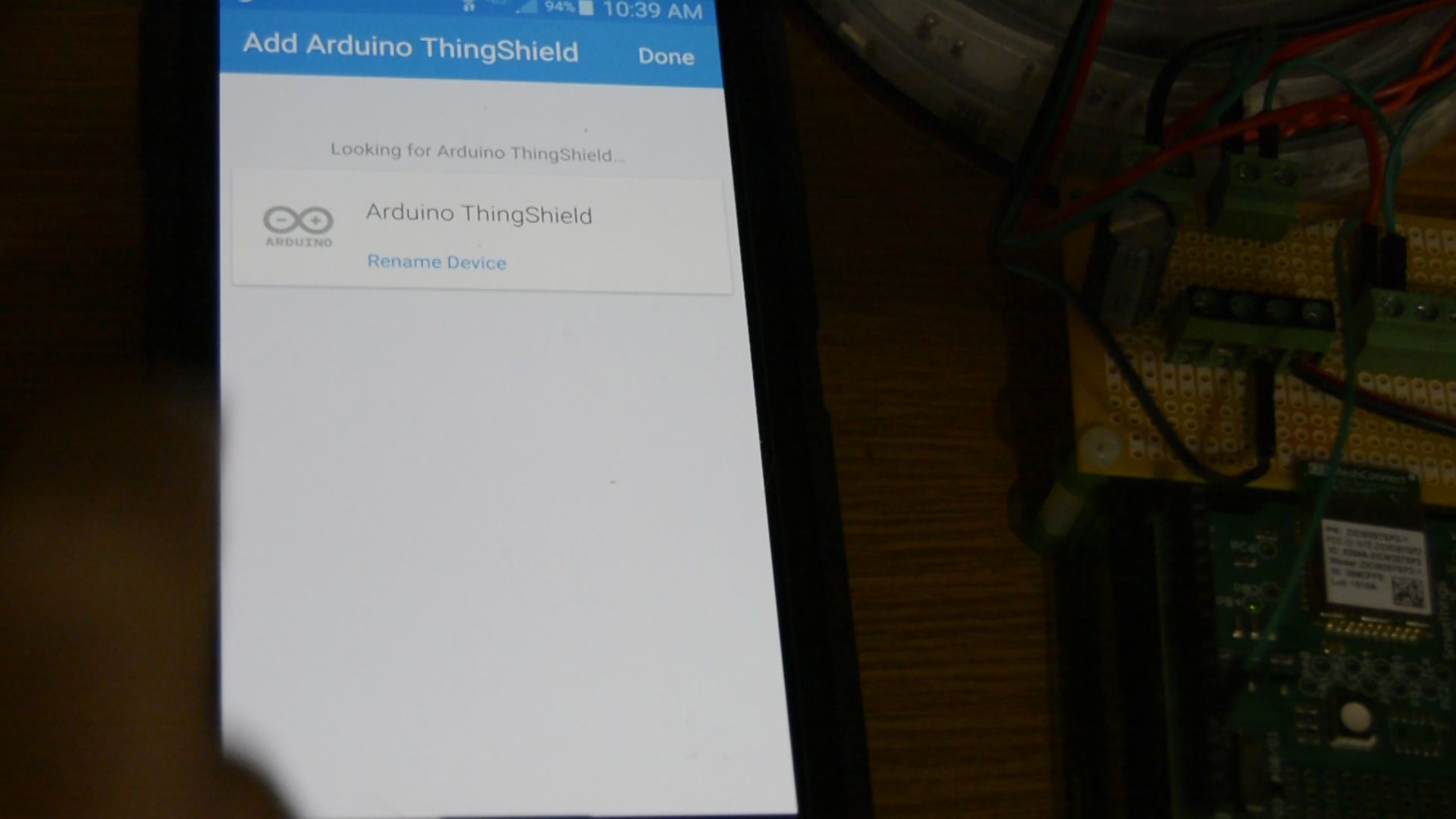

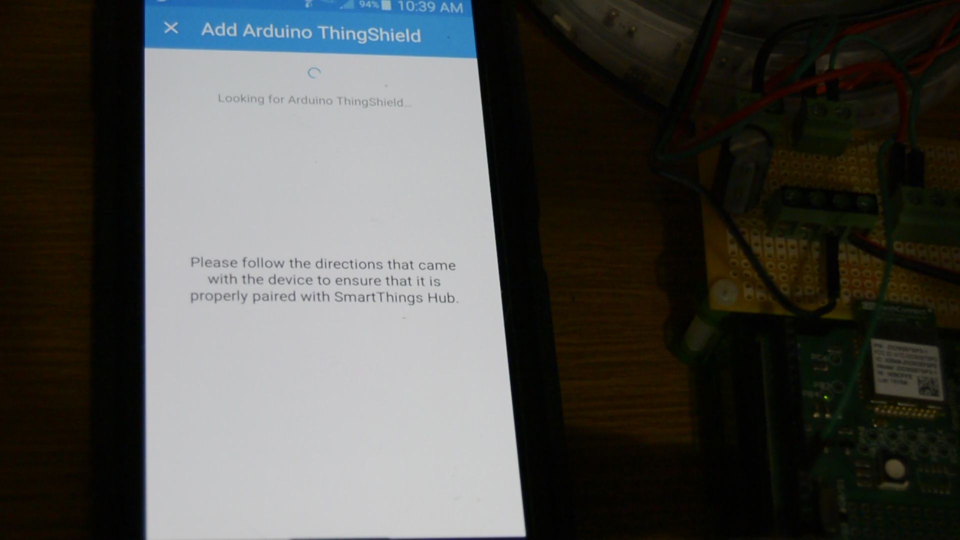

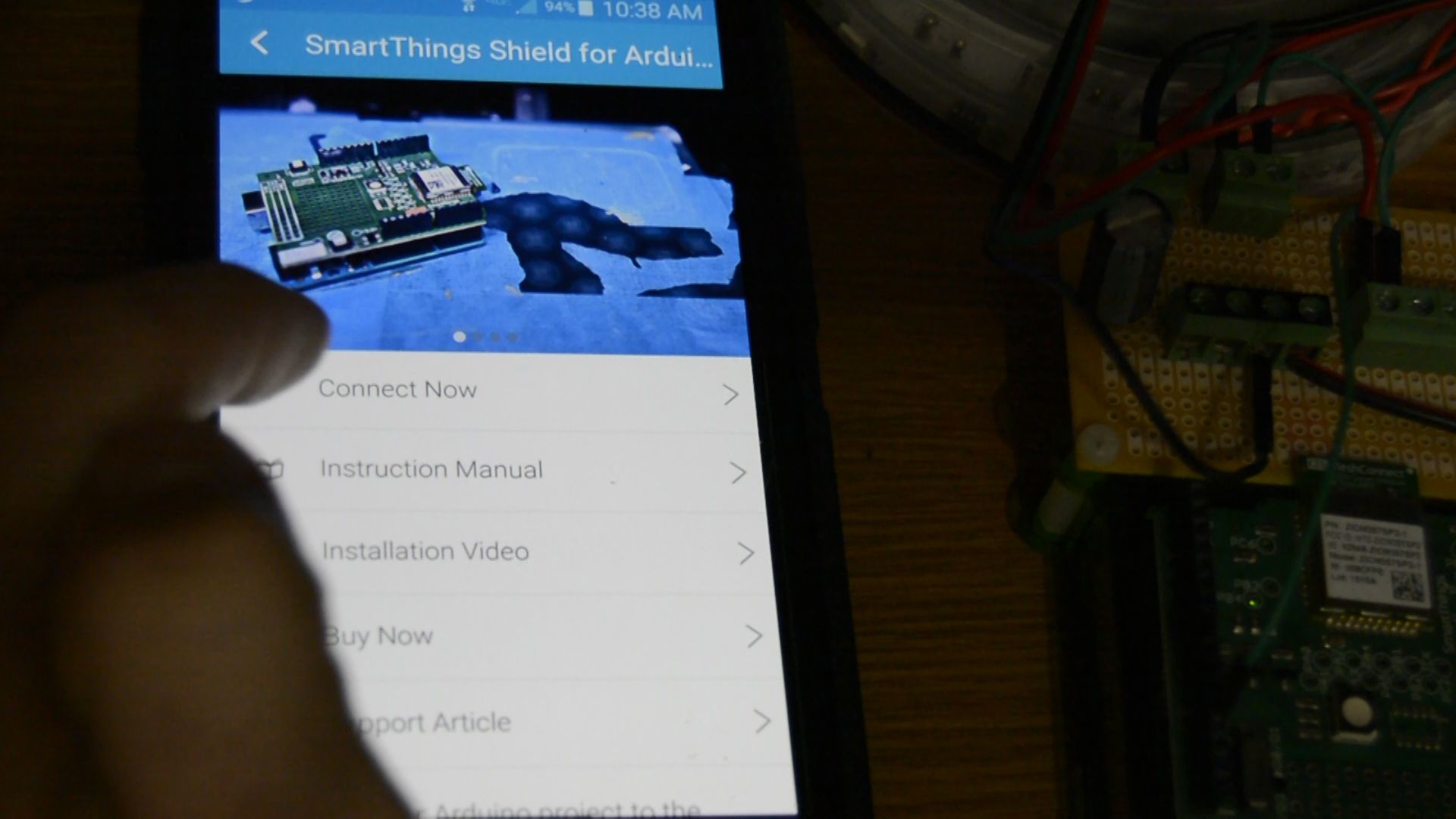

Now that we have our sketch uploaded to the arduino we need to connect the Arduino as a "Thing" to the SmartThings Hub.
- Open the SmartThings App on your phone or Tablet.
- Click the tab that says "My Home"
- Make sure you are on the "Things" tab and click "Add a Thing"
- You can let it find it automatically or Manually. Personally I find it faster for manual.
- Click the manual button.
- Scroll to the bottom and click on "Other"
- Now select the "SmartThings Shield for Arduino"
- Then "Connect Now"

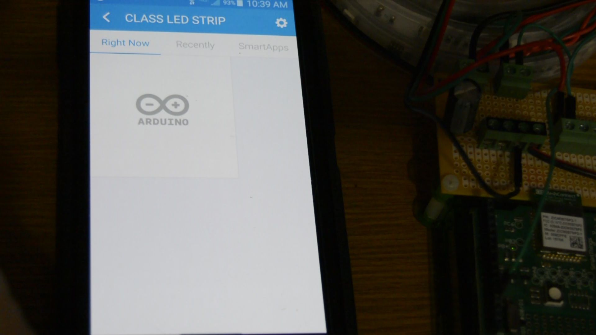

- SmartThings should find the Arduino and add it.

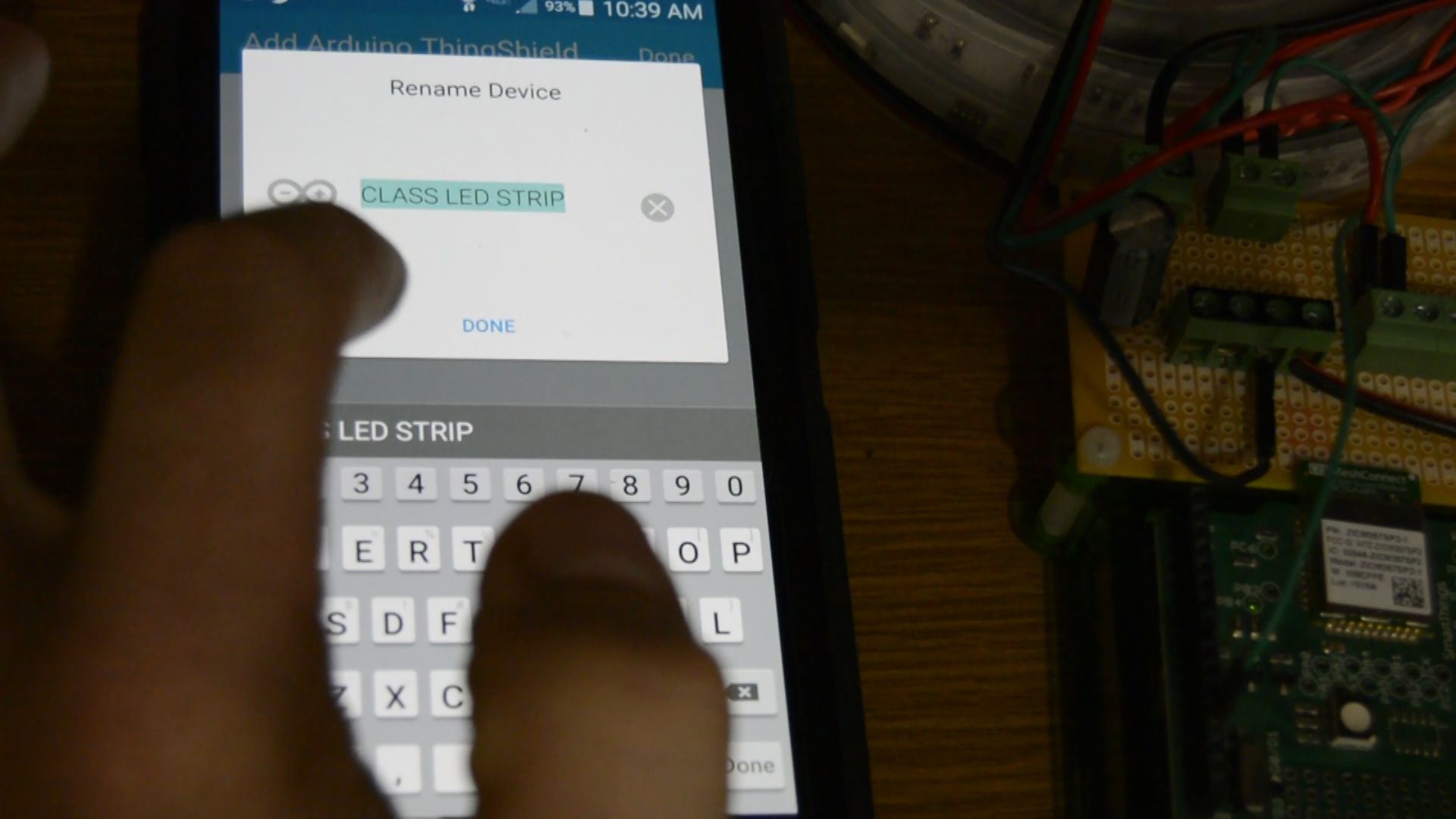

- Create a name for your device.
- Click "Done"
The Arduino will have no functionality at this point. Tally-ho....

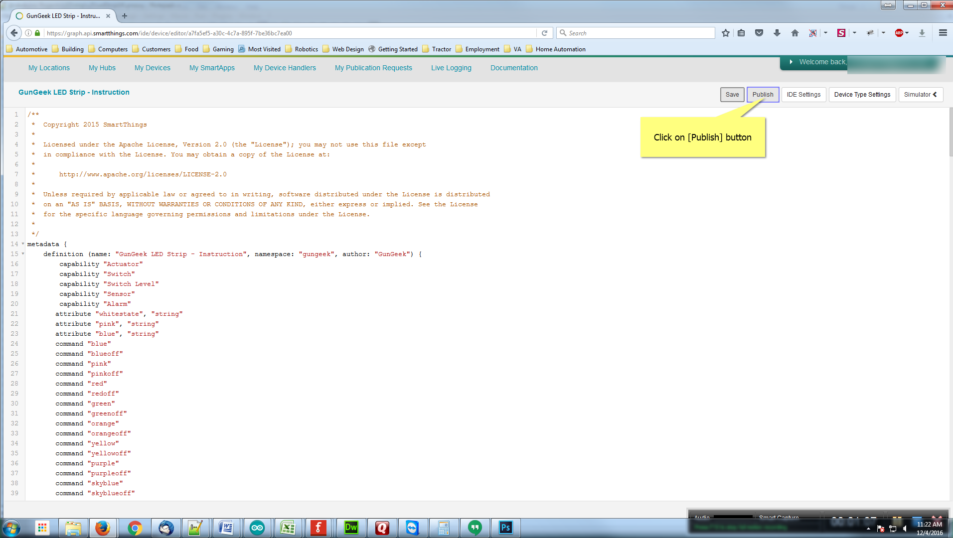

Step 7: SmartThings Device Handler
Now we need to dive into the device handler on SmartThings. I'm new to this part so this was the most difficult part for me. Some of the code might be able to be a bit cleaner but it works none the less.
Another change we made in this version starts here. Instead of having the tiles of all the colors always be the appropriate color, I wanted to be able to open the App and tell what color was currently on so we made some state changes for every color. Again you can step through the code with me on the video. Or just follow the steps below to use my code.

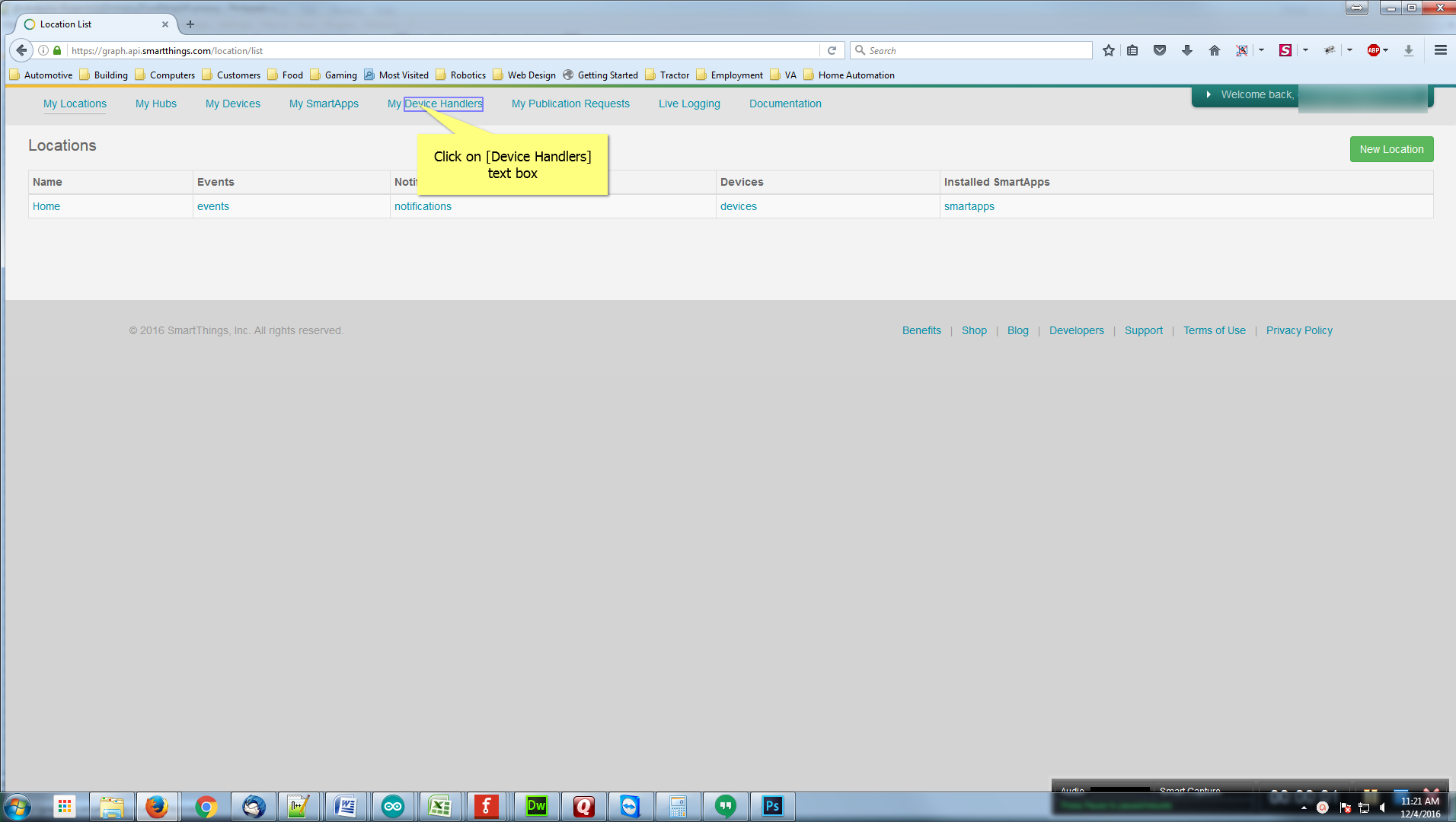

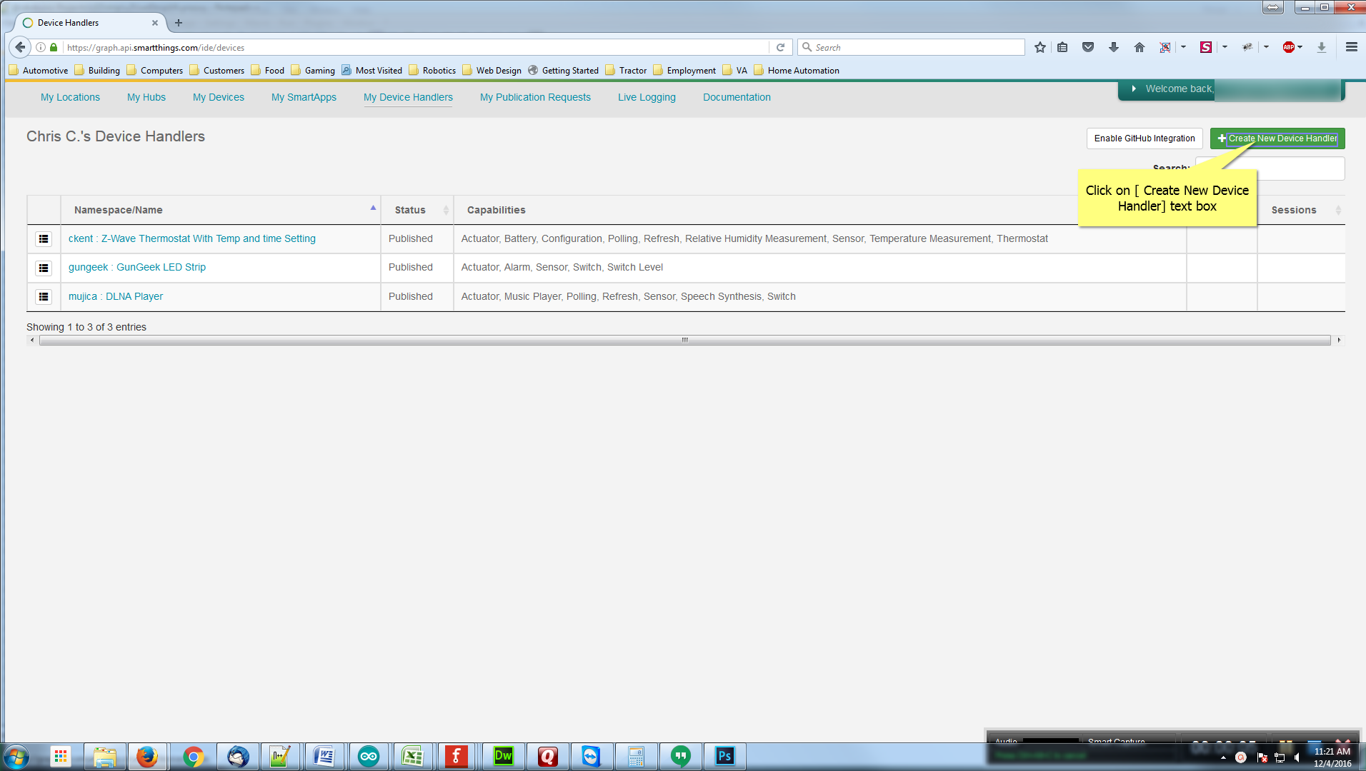

- Open www.graph.api.smartthings.com
- login with the same user name and password that you use in the app and when you set up your account.
- Click on "Device Handlers"

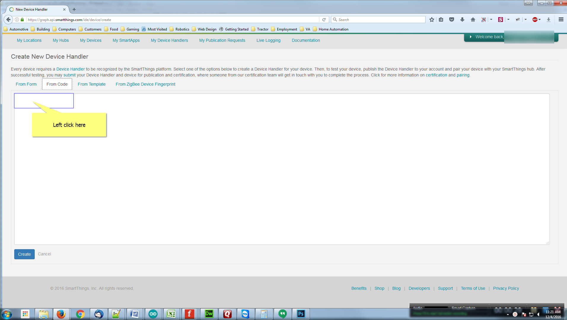

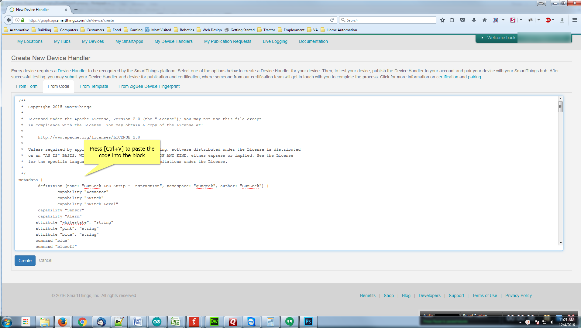

- Click on "Create new Device Handler"
- Click on the tab that says "From Code"

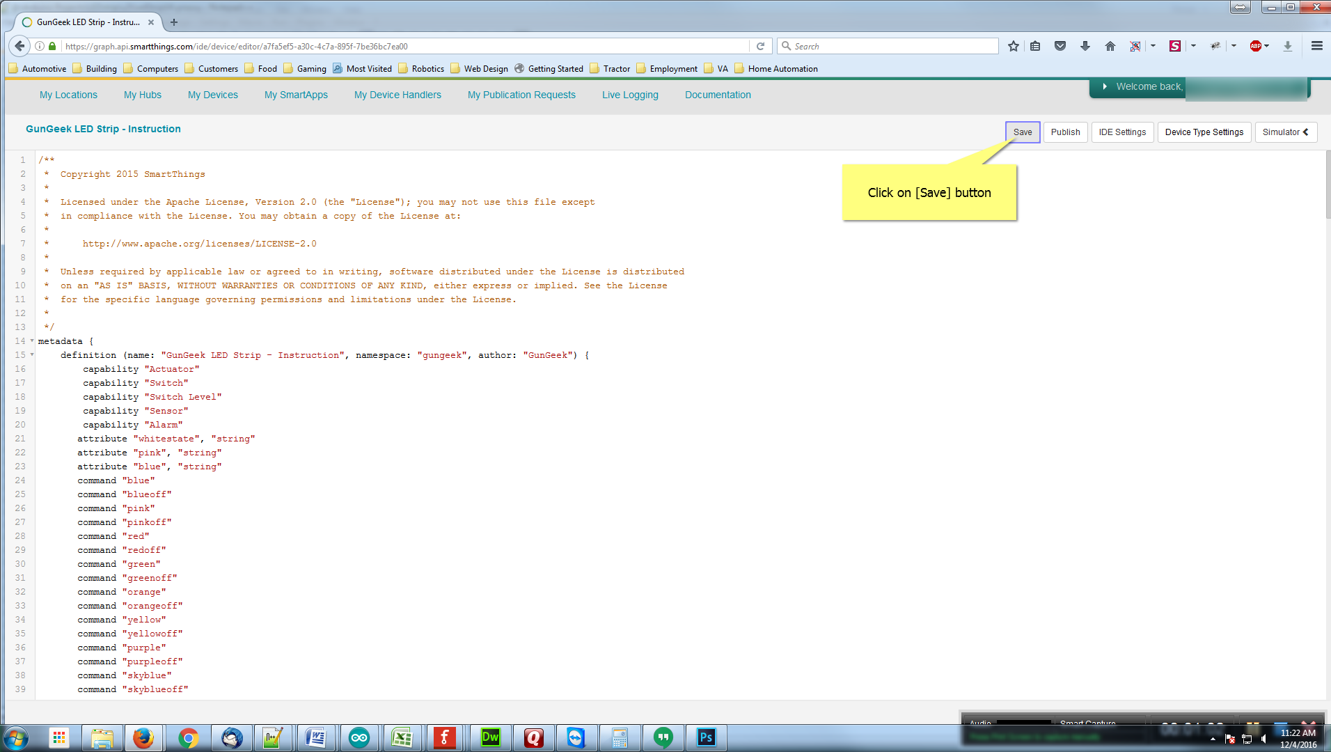

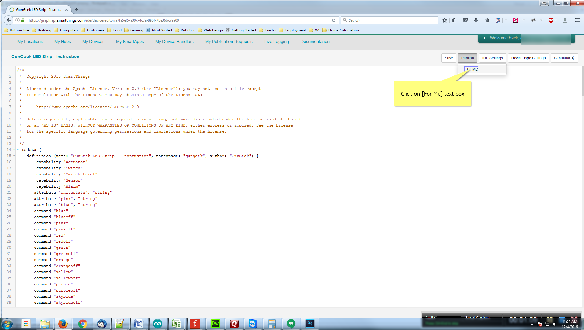

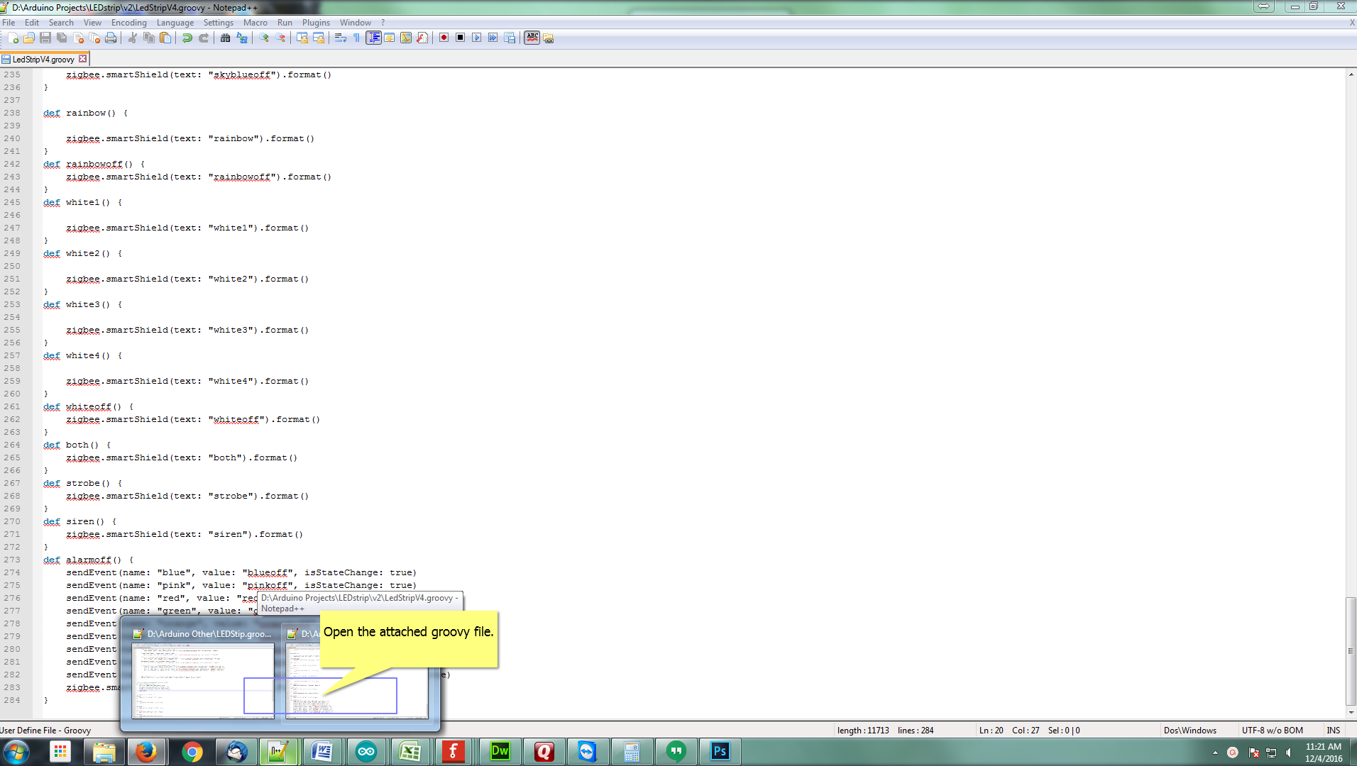

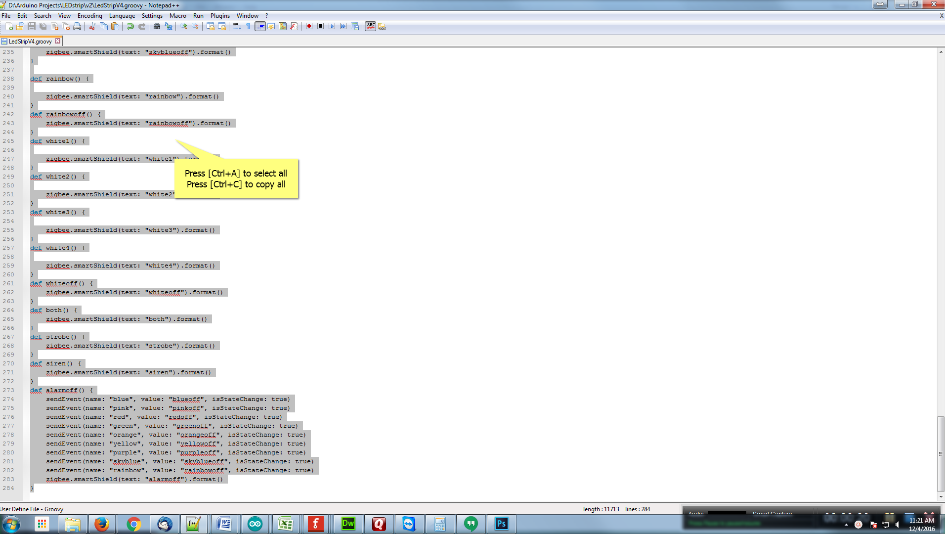

- Open my groovy file attached to this instructable in a text editor or if you downloaded notepad++ use that.
- Copy all of the code from my file

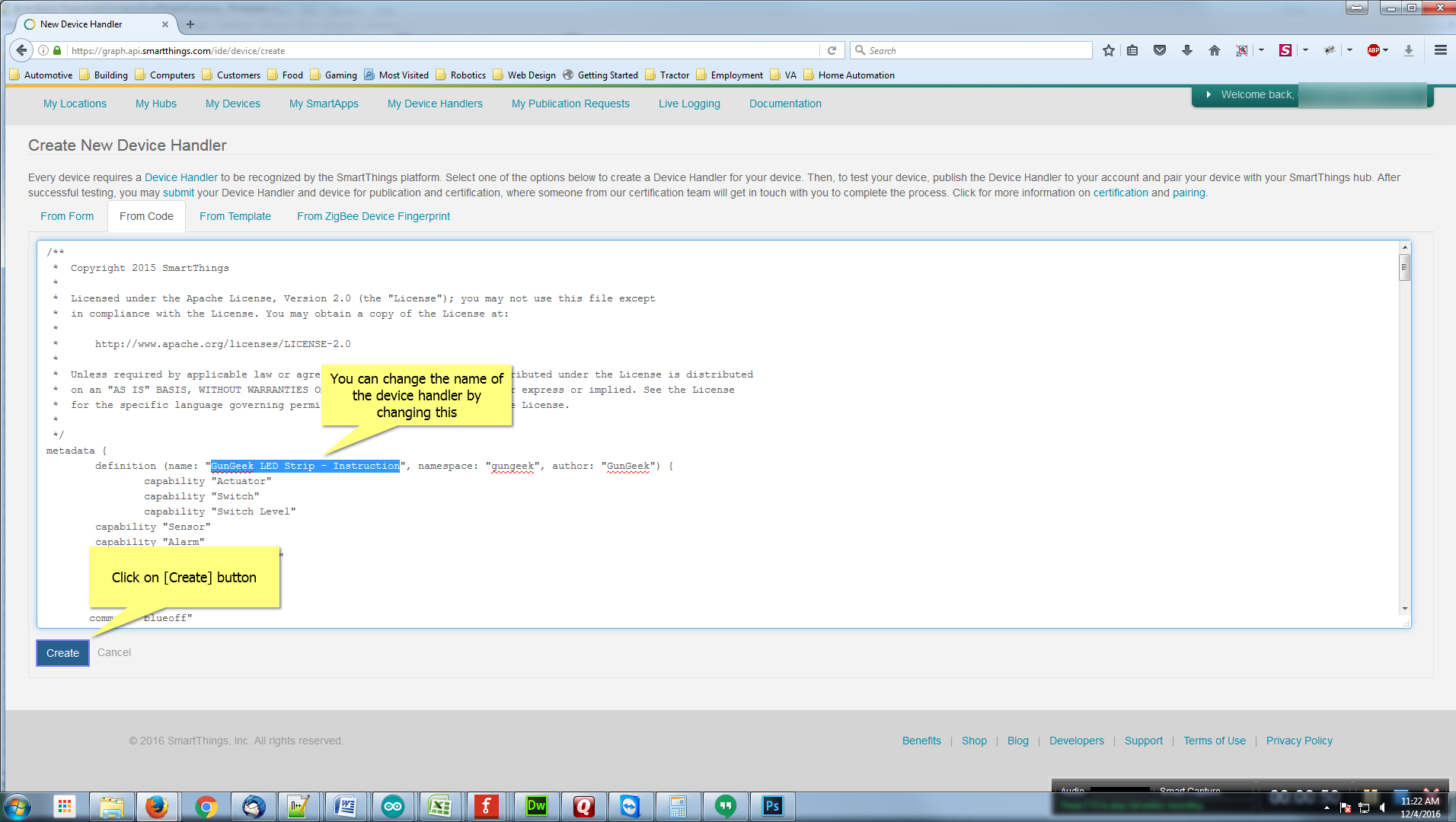

- Paste it into the code editor on smartthings.
- You can edit the name here as noted below, then click create
- Click on "Save"
- Click on "Publish" then "For Me"
Now our code is in SmartThings but the Arduino still will not do anything.

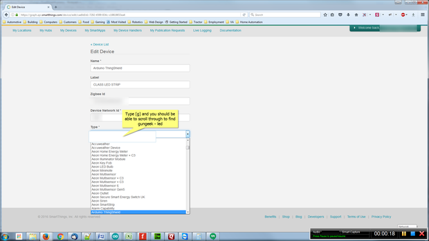

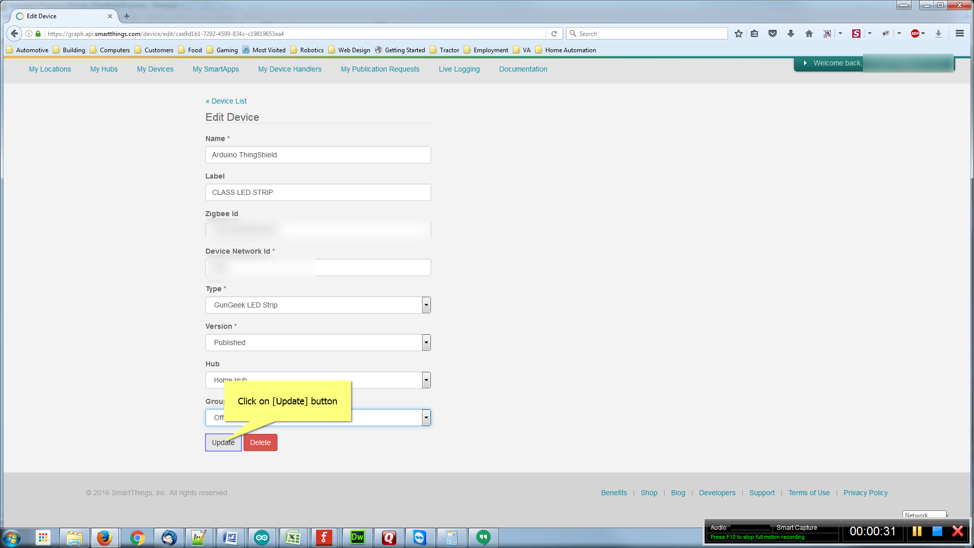

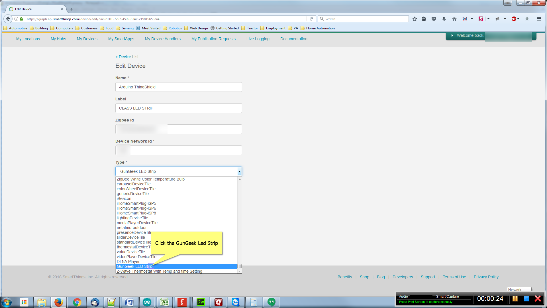

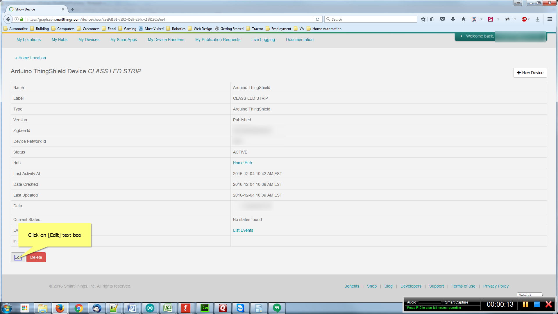

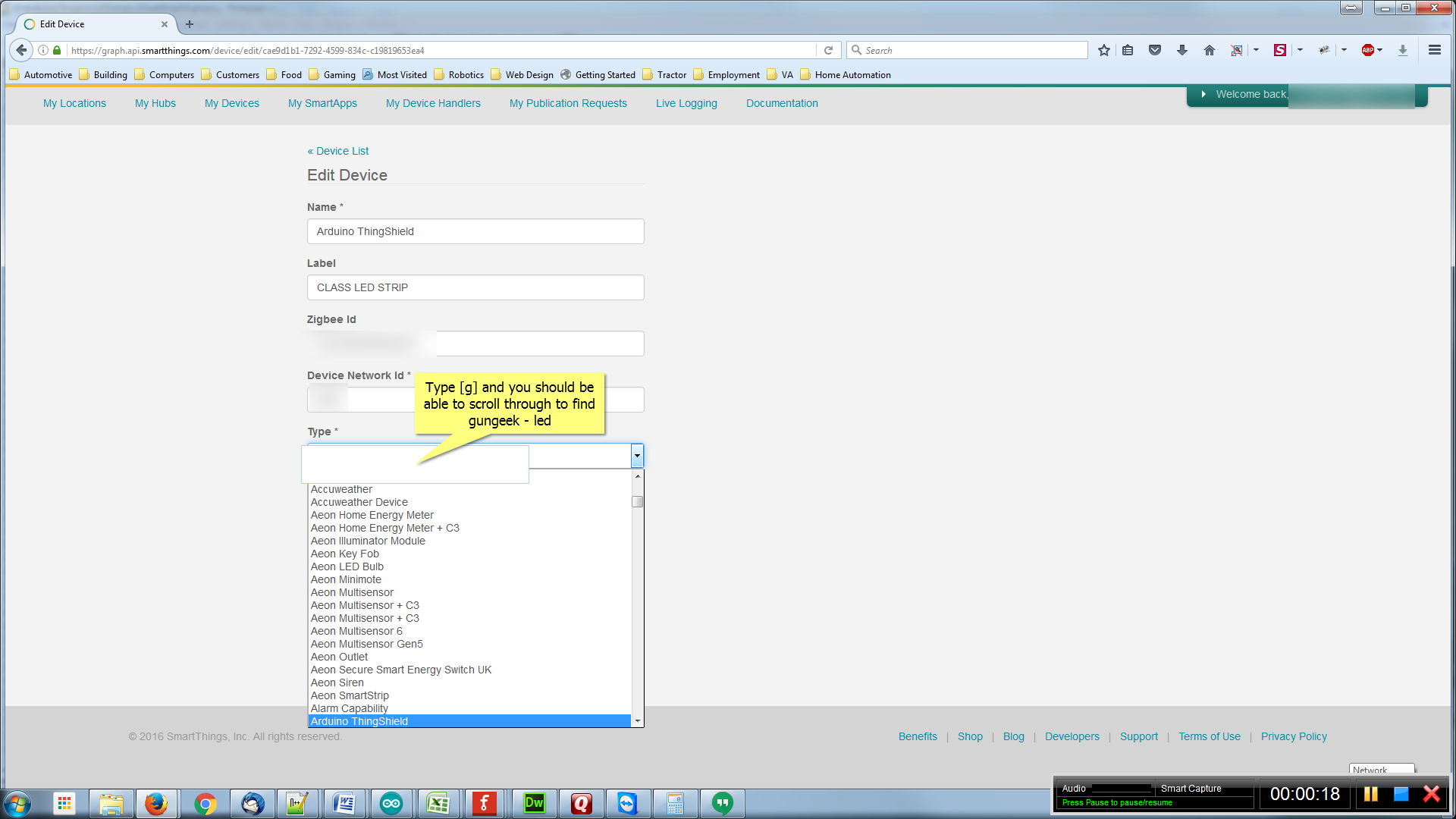

We need to change the device type of the Arduino to our new device handler.

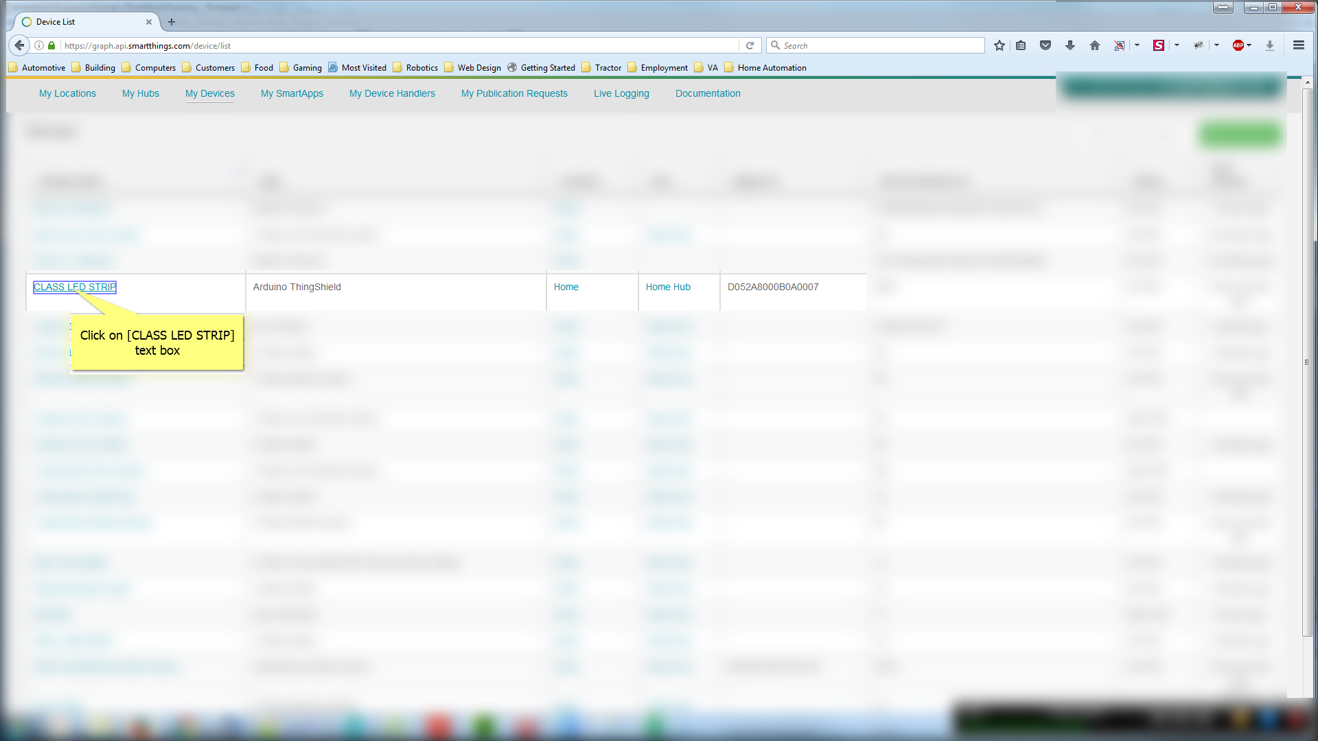

- Click on "My Devices"
- Click on "YourDeviceName" for SmartThings Shield

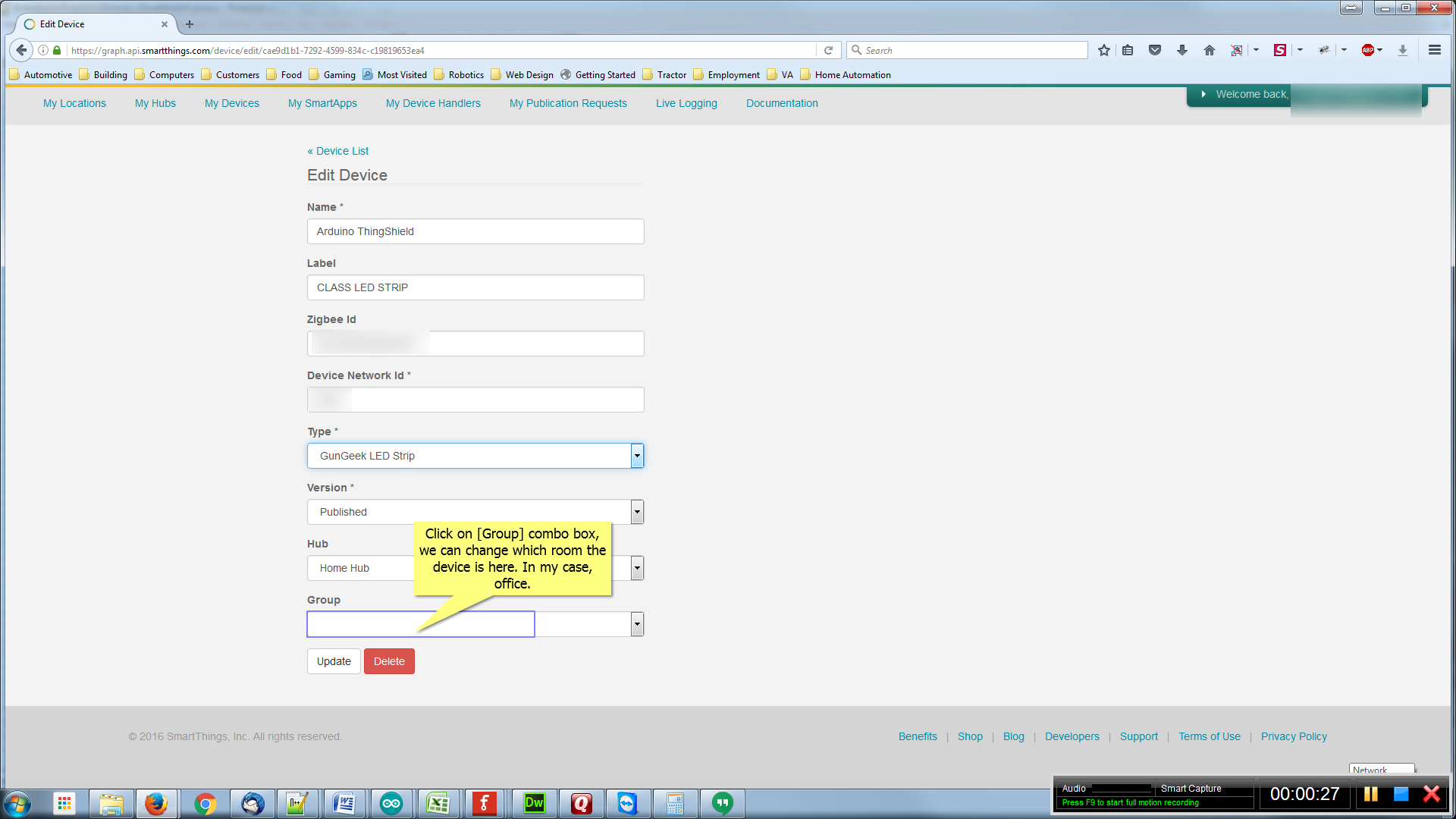

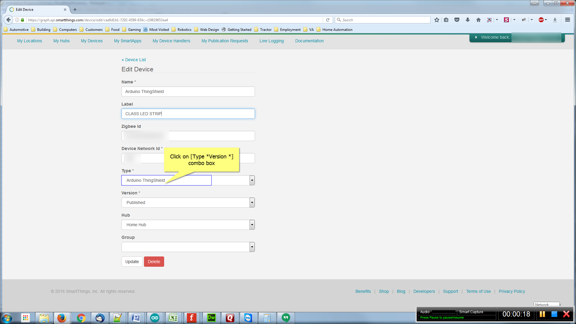

- Once it opens click on "edit" towards the bottom.
- In the "Device Type" drop down select the new device type we created.
- You can also update the room from here by clicking on Group
- "Click on Update"
Hence Forth good gentle people.
