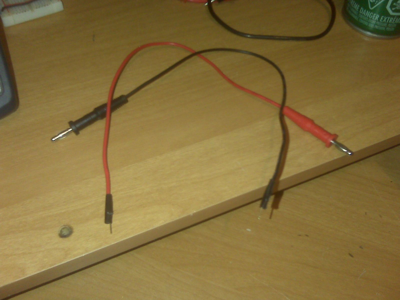

Now we will attach the Molex pins to the Binding posts. If you used the same type of binding post I used in this tutorial, then your life just got that much easier. The molex pins fit very snug over the binding post contacts, so solder is not required. If you didn't use the same type of binding post, then you may be required to solder your molex pins to the binding posts.
There are 16 binding posts all together. The first column should be 12V, the second should be Ground (GND), the third should be 5V, and the fourth should be Ground (GND) again.
Just remember, the red molex wires carry 5V; The yellow wires carries 12V, and the black wires carry Ground signal.
I've included the binding post diagram again for quick reference.
