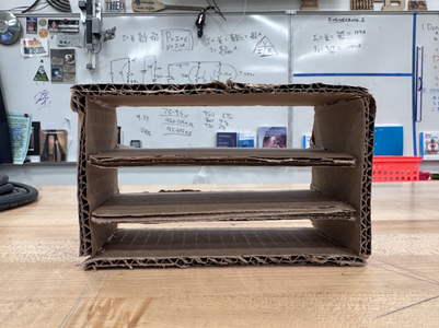

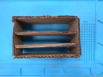

Step 1: Conceptualizing / Prototyping
My first step in conceptualizing the project was a lengthy process of measuring my room and my other furniture, and idealizing the right piece of furniture capable of holding the items I wished. I started by following a design from Amazon, and later began conceptualizing with a bookshelf in mind.
Realizing what was capable with the resources I had purchased, new ideas of how I could create my project began to sprout. When the piece arrived, the time frame had become quite short, leading me to conceptualize again, and in the end, I chose the simpler design.
Step 2: Fusion360/CAD
After choosing which concept sketch I'd use for my project, I opened Fusion 360 and confirmed that the shelf was possible on the plywood I had purchased. After even more drafting, I found out the perfect lengths of each cut of the wood and how each piece would be put together to make the project work. After confirming all dimensions had worked alongside the build, I prepared my sketch for a Fusion setup for it to be cut on the CNC router.
