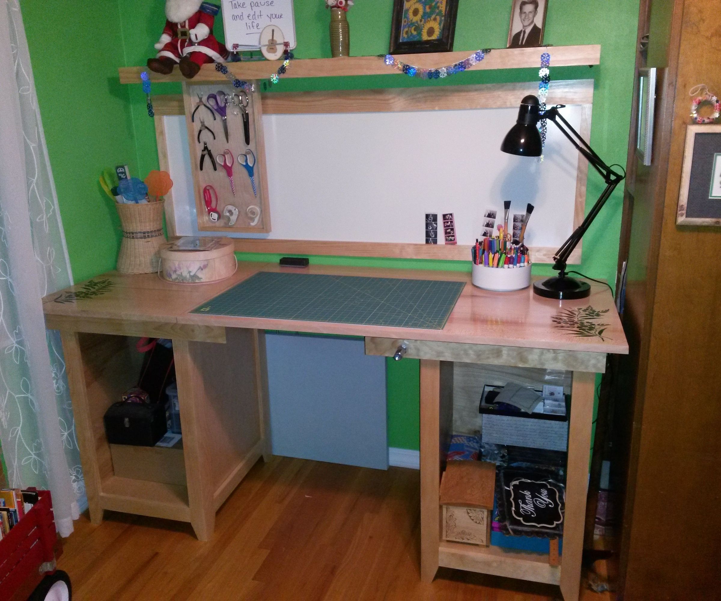

The design was for open front desk with cubbie type shelving across the back.
So... while my girlfriend was out of town for a weekend, I decided to build the desk as a surprise. I knew I could finish the carcass but certainly could not complete the finishing given the short time frame. I also needed her input for the drawer and shelving heights. When she got home is when the plan fell apart. I made a glue up top from quarter sawn American sycamore. She saw this top and liked it so much that she did not want to cut it or put holes in it unless there is no other option.
Step 2: Improvise
Now to avoid an extra cut in the desktop the entire right side will be a tilt up top. This destroyed the plan for a cubbie shelf on the back of the desk because there was no place to attach the shelf supports and anything back there would prevent the drafting top from moving.
So I had the idea to make the shelving move. I would use a track and roller system attached to the bottom side of a floating shelf mounted directly to the wall. This would allow for a larger whiteboard on the wall. The organizer could be moved so things are always on hand or out of the way as necessary. Several shelves could be built and placed on the track depending on the project at hand.

The better option is to put deck screws directly into the studs. If you are lucky like me, whoever built your house added just enough plaster over the drywall that you cannot "sound" the studs or use a stud finder. Here is a hint, find the outlet on the wall, and take off its cover plate. On one side, there should be a stud. Locate it and then measure 16" from the stud to test for the next one. The only real test is to put a screw in the wall. Screw at a height so it will be hidden when the shelf is hung. If you miss the stud but think you are close drive the screw through the same hole at an angle to see if hit it. Once it is found, mark its location with painters tape; the tape is about the same width as a stud and will not damage your wall.
Now get a friend, spouse, or anyone you can bribe with a beer to come help you. A 2nd set of hands are invaluable at this point. Both of you need to hold the floating shelf in the correct location as you place the first screw. Make sure it is the correct distance from the wall and level at the height you want. It does not have to be perfect when you drive the first screw, but the closer you are, the easier everything else will be. After 1 screw is in, only one person should be required to hold the shelf. This allows the 2nd person to check level, elevation and drive the other screws into the studs. The job is basically done. Add the hanging organizing shelf to the track and start clean up.
Step 9: Demonstrat
As you can see in the video the floating shelf is very stable and the hanging shelf freely moves from side to side.
