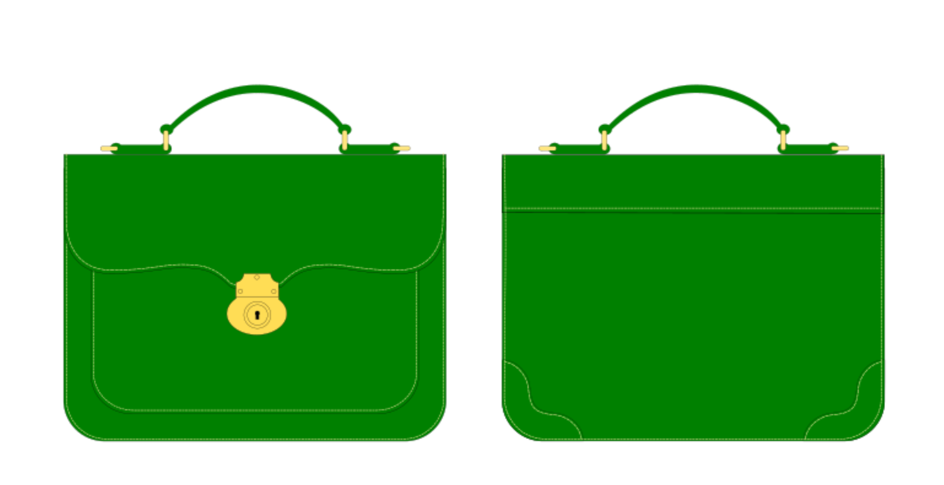

Step 2: Pattern
I've included the full pattern to this step in PDF, PNG and SVG format. I'll reference this pattern throughout the tutorial. I usually copy the larger pieces to a piece of cardboard so I can plan out where to cut from my hide to avoid defects. I like to print out the smaller intricate pieces, tape them over my leather, trace with a pen and then use the indentation to cut them out.
Before I start each bag, I usually do a series of mockups in Inkscape to get the proportions and general look right, as well as try out different hardware. This is what I ended up with as my final design:

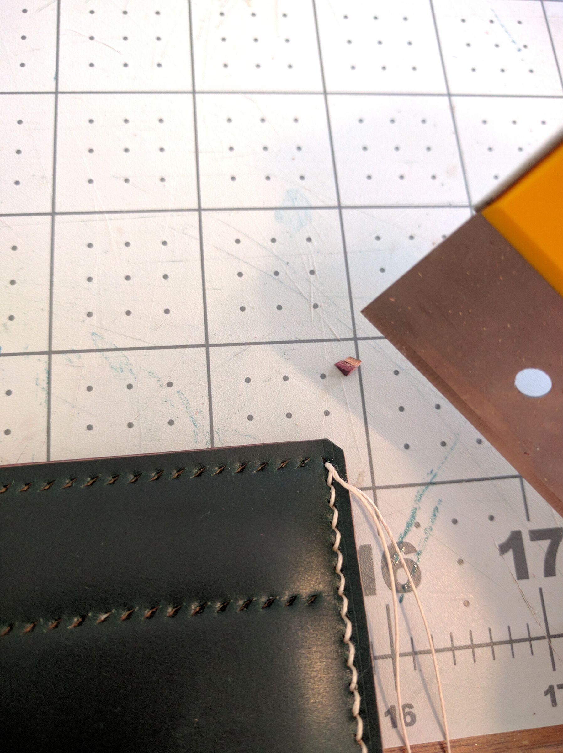

Step 3: Technique: Stitching on a Pony
Before I dive in, I'm going to cover a few basic techniques: stitching on a pony, stitching over a table edge and edge painting. Of course, there are a myriad of different ways to do all of these processes, and I'll just write about my preferred methods.
This step is how to stitch on a wooden stitching pony or clamps, when your piece can fit into it. Using a pony will drastically improve your stitching speed. Look through the pictures and annotations in order.
The key to consistent stitching is to keep a few variables the same every time you make a stitch. These are the stitching variables to pay attention to:
The side I punched on faces right. The direction of stitching is towards myself. The first needle goes into the hole from the back side, which is on the left. Pull the first needle through. The second needle goes under the first needle, forming a cross. Turn the cross anticlockwise 90 degrees. The second needle goes back into the hole below the first thread. Pull the second needle through. The right needle should be pulled tight up, right and away from you at an angle. The left needle should be pulled tight down, left and towards you at an angle.
Everyone will have their own preferences on how to stitch and their own muscle memory for the bolded items. The most important thing is to be consistent.
With this stitch, you can generally get a good angled back side, if your leather has a combined thickness of 6oz and above. If your leather is thinner than that, your back side will end up a bit straight. (This is why some of the edges in my project are not skived, since my leathers add up to barely 6oz thick.)

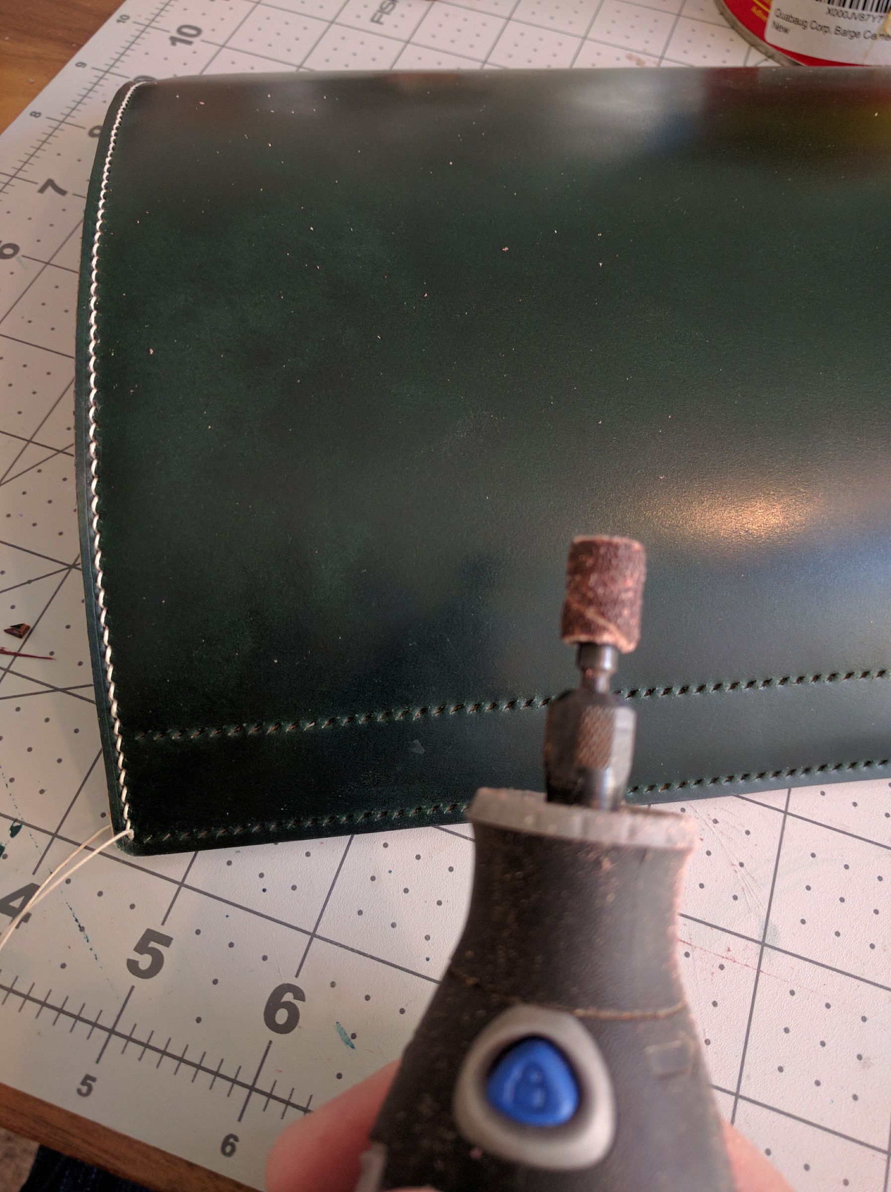

Step 5: Technique: Painting Edges
Last technique I'll show is edge painting. There are a million ways to do this but this is the method I use. I never really got the hang of using a fileteuse so my method involves sanding and painting only.
I chose to demonstrate painting the handle because has many layers and a very thick edge, making it the hardest part to edge paint. My brand of choice is the Fenice paint that Buckleguy sells, along with a big bottle of Fenice clear primer. Another option is Giardini, which I used in a previous tutorial but it found it hard to apply, about twice as much work and started it peeling off with very light usage.
Check out the pictures and notes in order to see what I'm talking about below.
With many layers comes the potential of many pits, gouges and seams that will show up in your paint layer, which means more work. My strategy is to use the clear primer to build up thick layers and fill in defects before applying any colored paint. The clear primer is more watery and sticky and dries hard. This means it will flatten itself out, fill in gouges and form a good foundation, which saves you time.
These are the steps:
  1. Sand down the edge as straight as possible. You can use a dremel or coarse 200 grit sandpaper.
  2. Lay down a thick layer of clear primer, almost like a rain drop. If you get any over the edge, wipe off quickly with a paper towel.
  3. Let dry for one hour. Keep the edge upright so the watery primer doesn't run or drip.
  4. Lightly scuff the primer with 400 grit sandpaper. You don't have to sand out any imperfections yet.
  5. Apply two more thick layers of clear primer, putting more primer over areas with seams and gaps. Allow one hour of drying time between each layer. You want to end up with a smooth, bubbled surface.
  6. Then, pull out your colored paint and apply a thinner layer to the top. Allow to dry for an hour.
  7. Now you should start sanding with the goal of removing all imperfections and gaps. I start with 400 grit sandpaper and finish with 800 grit paper. Gaps and pits that haven't been sanded yet will be glossy. Aim for a completely matte sanded surface before continuing.
  8. Let dry for an hour.
  9. Repeat steps 6-8 until you are happy. As you approach your final layers, use thinner and thinner coats. This handle took three layers of primer and three layers of paint, which is not too bad.
  10. Finally, rub a layer of protective beeswax onto your finished edge and rub vigorously with denim or a microfiber cloth, buffing to a shine.
Remember all this as you will be finishing many edges!

Step 18: Gluing External Front Pocket and Internal Front Lining
Now I mate the exterior of the front bag (with large pocket) with the purple interior lining of the front bag (with small pockets and key fob).
  1. Cut out a piece of Moontex stiffener, 3/8" smaller on all sides
  2. Glue the stiffener to the exterior front bag
  3. Glue the lining piece together (remember, it is oversize), using wax paper between the pieces so you can align them slowly
  4. Trim off the excess lining

  7. I rounded off the sharp corners at the top of the flap. I cut the corner at an angle and used a dremel to round off the corner:

  5. Edge finish completed edges
At this point the main body is done and it's looking like a bag. The only steps remaining are to make the handles and attachments, and install the lock.

    By the way, what grit is the sandpaper on your dremel?
    0
    Scwleung
    Scwleung
    Reply 5 years ago
    Yessir, this is my very first wallet from Feb 28, 2015, and the third one I did in April 2015: http://m.imgur.com/a/9cct5
    Can't remember the exact grit, but it's one of the coarser ones. I use the dremel for rounding off seriously jagged edges or reshaping so I want it more abrasive.
