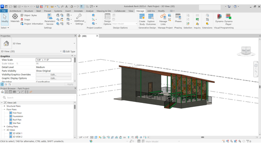

I used this project as an opportunity to dive into parametric design and the parametric design features in Revit. I created custom picnic tables and benches using Revit families, and a statement wall with concentric circles using Dynamo. To go along with this instructable I have written an instructable with a step by step guide on using Dynamo to create the statement wall and am working on writing a guide on how I modeled the tables. In this Instructable I will be going over the design & rendering of Shelter 7, and I have linked the Instructables for the Circle Wall below:

I modeled parametric picnic tables and benches for this project using custom Revit furniture families
Both these tables and their Revit family were designed with adaptability in mind. The Revit families have adjustable parameters for length, width, height, materiality, and number of legs, and have parameters for creating ADA accessible roll under tables.

I used Revit to draw floor, electrical, and roof plans for Shelter 7. The shelter has a large elevated platform with a storage closet and restroom to one side and a ramp behind it. Behind the ramp is a rain garden filled with native plants. In order to keep Shelter 7 accessible to all patrons 5’ turn radii were included throughout the design. The Shelter's ramp also exceeds ADA requirements for slope and landings. The shelter has a sloped roof equipped with solar panels to improve the sustainability of the design and provide electricity to the covered outlets in the shelter. The full sheets are attached at the bottom of the instructables.
