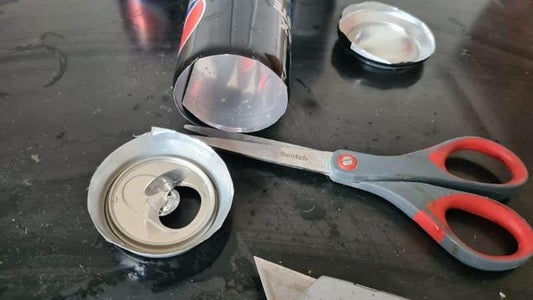

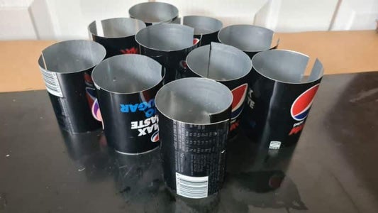

Step 2: Cutting the Aluminium Cans

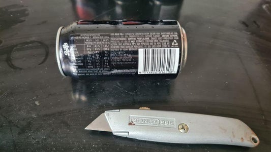

Working with aluminium cans can be sharp, so wear heavy gloves.
  1. Pierce the can near the top with a knife.
  2. Cut off the top, then slice down the side.
  3. Remove the bottom of the can.
  4. Open and flatten the aluminium sheet—rolling it backwards helps remove the curve.
Each can produces around 24 usable discs using a 1-inch punch, so depending on your board size, gather plenty of cans. My project needed 1,495 discs, which worked out to 72 cans.
