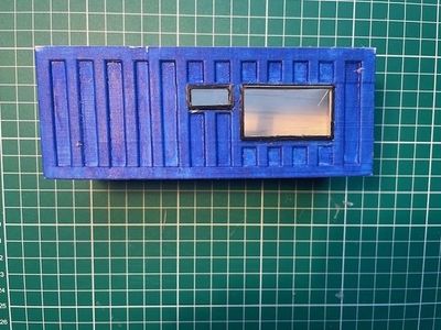

After placing the furniture, I also wanted the house to have some natural light, so I added two windows; one smaller above the kitchen sink, and another larger one in the living area. Their dimensions (width) were determined by the slots in the exterior wall of the shipping container, making their addition easier as the container comes with guidelines for their cutting.

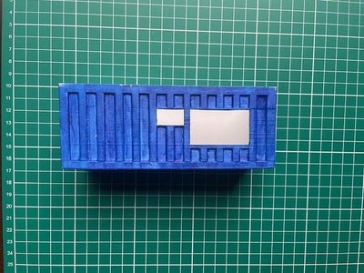

Step 2: Creating a Physical Model - Preparing the Container

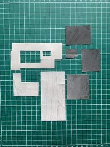

The physical model was constructed as a 1- 42 replica of the actual design. After modelling and 3D printing the shipping container, I painted the model blue. Next, I cut and glued down popsicle sticks to create the floorboards. Finally, I took my Home Depot tile sample pamphlets, cutting out and securing "wallpapers" of the materials I wanted to line the walls of the home.

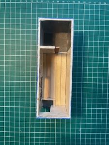

Step 3: Physical Model - Furniture
After the shipping container shell was prepared, I printed my furniture models to the same scale, and used hot glue to secure the down according to the floor plan established in CAD. For certain pieces like the cabinet, which I wanted to have wood accents, or the bed frame, which I couldn't make with good quality on the printer, I used toothpicks and hot glue to frame the furniture. In hindsight, I probably should've picked a different adhesive, as the process of removing the hot glue strings was tedious, and probably the most frustrating part of the build.

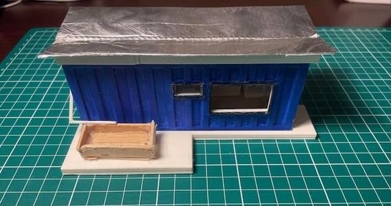

Step 4: Physical Model - Exterior Features

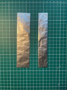

Next, I printed the roof files and wrapped in tinfoil to give the impression of a sheet-metal roof. I didn't use any adhesive, simply friction fitting in place, as I wanted to be able to remove the roof to get an interior view of the build. For finishing touches, I made the planter out of popsicle sticks, added some piping to simulate a rainwater collection system I'd planned for, and added a placeholder for a solar panel.
To finish the architectural model, I printed the base that everything would sit on.
