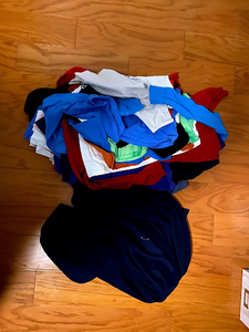

First, you will need to gather all the T-shirts that you don’t mind not wearing anymore. I personally found 28 but used 24 so that I could make a 6ftx4ft blanket. Feel free to use more or less than that. For the purposes of this instructable, I will be explaining how to make a 6ftx4ft blanket.
Tip: Washing and laying the shirts flat on top of each other will make a relatively wrinkle-free shirt. This will make it much easier for later steps. You may also iron them if desired.

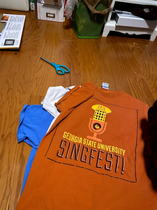

After gathering your materials, you can start cutting up your shirts. To make a 12inx12in square you must add an extra ¼ inch on each side for seam allowance. I made a 12.5inx12.5in cardboard square to trace where I will be cutting on each square.
Step 3: Cutting the Fabric
I traced the square with a sharpie on the back of the shirt. I then used my rotary cutter, acrylic ruler, and mat to cut out the square. Do this to every shirt and organize them as you like, I did 4 columns of 6.

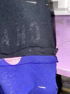

Once all squares are made, bring out the sewing machine. Pin the tops and bottoms of each square to each other, be sure the right edges are touching
Tip: If the corners don’t line up perfectly, pin the center then from the inside out and stretch a little to line them up.

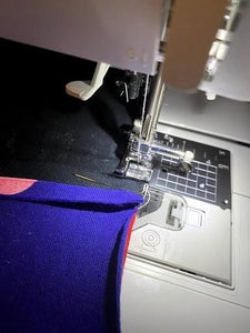

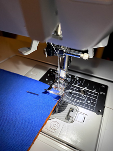

Straight stitch these two squares’ edges together with a ¼ inch seam allowance. On most sewing machines, the needle should be centered so the edge of the presser foot is at the ¼ inch mark.
Tip: To anchor the stitch, start by sewing down 1 cm, next reverse stitch on top of that, then begin sewing all the way down. To finish off the stitch, reverse 1 cm at the end, and then go back to the edge.

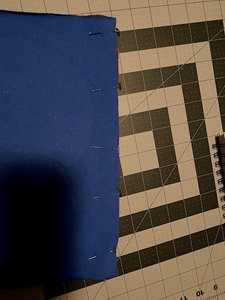

Now, we will be sewing the columns together. I first ironed the seams open, then placed the front side of the first column on the front side of the second, then pin the right edges together. Make sure the seams line up and that the top square of both columns are at top facing each other.
Step 8:
Repeat the last step with the third and fourth columns, these will become the right and left halves of the banket.
Sew the two halves of the blanket the same way you sewed the two columns. You now have all your squares in one big rectangle. Iron open all the seams on the back. This is where our thin blanket material comes in.
