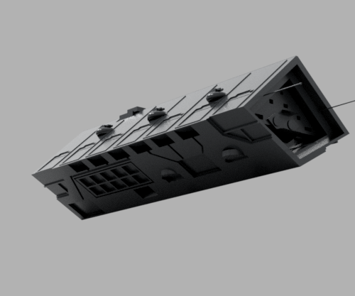

Step 44: Chasis Extrude
Start making the chasis, I started with a large rectangle and a trapizoid
Step 45: Chasis Back
Create the back part. it is a heavily tapered rectangular extrusion from the bottom. All corners are filleted by .03 and the lines are created by mirroring 2 thin rectangular extrusions, chamfering the end, and creating a middle rectangle that is also chamfered. Upper part of the rear is also trimmed.
Step 46: Chasis Outcropping
Creat an outcropping on both sides by reducing the width of the rectangle and then extrucing a section 1 1/2 the width of the support and chamfering the sides. Front can also be reduced in length if it is too long.
Step 47: Chasis Joints
Use joints to connect the supports along with the turret-barrel assembly to the chasis
Step 48: Chasis Mirror
Mirror the rear cover to the front, chamfer the front corners by .5in
Step 49: Chasis Grill
Create the front grill. It is a rectangular pattern with 4 replicated rectangles, each are chamfered the maximum amount on bother sides. More of the front is also reduced here on the sides.
Step 50: Chasis Support Cover
Create the "tab" shapes obve the supports by connecting 2 circles and extruding up. Fillet and create a rectangular pattern above with 5 copies and mirror.
Step 51: Chasis Chamfer
Remove visibility of all other components and chamfer the bottom edges inwards, making a bit of a boat shape
Step 52: Chasis Interference Cut
Use the peg from the turret component to cut out an interference in the main chasis.
Step 53: Chasis Interference Cut 2
Use a fully assembled track component oriented diagonally to cut out an interference in the chasis. You would want to remove all the details that were left behind to make fitting on the print easier else you will have to sand/grind it later.
Step 54: Chasis Chamfer 2
Chamfer the top slightly to remove the 90 degree edges except for the outcrops that will attach to the supports
