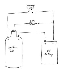

Step 1: Schematic Overview
Take a peek at the pictures for a basic schematic of the project and an overview of the setup. I labeled the colors so you could keep track of what comes out on either end of the cable.
The basics are that the coil steps the battery's voltage way up but because we are using a small 6 V battery the current is low. The mercury (tilt) switch activates the circuit and you get a shock.

Run the red wire (based on my diagram) out the first hole (from the inside). I hot glued it in place before I went any further. Shape the wire so it runs tight along the seam and then back in the other hole.
The second contact wire is the one that connects to one side of the mercury switch (refer to the diagrams for which side). I already had some multi-stranded wire soldered to the switch so I won't be using the same kind of cable that we just used so I picked one of the individual strands of wire and then cut the rest of them off.
Insert the wire in the first hole and then glue the wire in place (see picture). Shape the wire just like you did the first one and run it back in the second hold and bend it to hold it in place.

Connect the wires as shown in the diagram and arrange them so there is clearance to put the mouse back together. I used wire nuts to connect the wires because they are less work than soldering and heat-shrink tubing but they take up a lot more space and I had to hot glue them in place to keep them from getting in the way when I was closing up the case.

Follow the diagrams and color coding to connect everything on the coil and battery side. You'll probably need to solder the wire to the output of the coil (center connection). This was a pain originally because it was hard to get the coil side hot enough for the solder to stick. I soldered this connection a long time ago and have just left the wire connected and re-attached it to my various projects.
I added a switch between the negative of the battery and the black wire in order to be able to shut off the mouse so I don't shock myself (anymore than I already have in testing the thing) and so I can transport it without running down the battery. I placed everything in a box and added some cardboard to fill in the gaps so the parts don't roll around. You definitely don't want to try taking this with you on a flight because you'd make the evening news!
