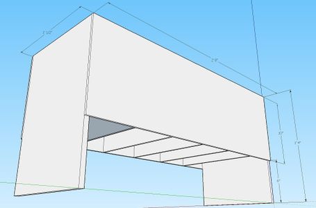

After thinking about the storage and sit problems for awhile, Sketchup was used to sketch a box/bench that would fit in the space between the open door and duplex outlet.
