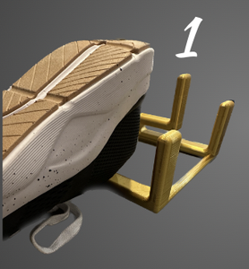

I started creating the file for my shoe holder very first thing, so it would have time to print and it would definitely fit the shoe. The SLDPRT file I've created is fit for a size 11 men's shoe, so if you bought another size or type of shoe, you will likely need to modify the Solidworks part. To get the shoe onto the shoe holder, I had to take out the padding on the bottom of the shoe (also making it easier to drill through the sole later) and then slide the shoe down and twist it on. It is slightly hard to get the heel of the shoe onto the small ridge, but as long as you gently slide it together it should fit perfectly. The taller edge should be the one inside the shoe, and the flat edge should be the one sitting on the lower sole. The Solidworks file's link is given above in the materials section.

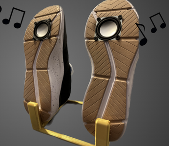

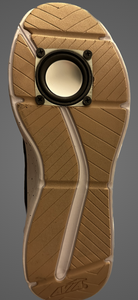

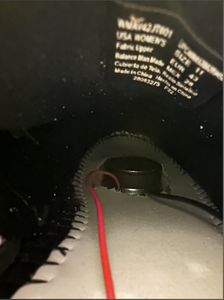

Next, you need to cut holes for your speakers to fit in. The speakers in my shoes were 2 inches in diameter, so I used a two inch hole saw. You need to attach the hole saw to the drill head and drill into the sole of the shoe at a preplanned mark on each shoe. Ensure you have the center the same on both shoes so they're even and aesthetically pleasing. To prepare to enter your speakers into the shoe, you first need to solder a red wire to the positive part on the back of your speaker, and the black wire to the negative part on the back of your speaker (these connections need to be long enough to stick out of your shoe). Then after drilling through the whole sole, I threaded the speakers through on the outside. I found trying to attach these on the inside would be very difficult to secure and ensure that they'd stay. I then drilled the screws into the sole through the speakers to secure them. I pulled the wiring through the shoe down to the heel, so they could connect on the outside. One of the shoes should have majority of the wiring while the other only has a speaker. The only two wires on the outside should be the shoe with no wires inside and the wires that connect from the audio amplifier to the speakers. (Second image is of the inside of the shoe).

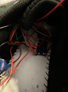

Using the soldering model and/or the mock up with the breadboard, solder the pieces into the shoe and hot glue or electric tape them to the sides of the shoe to secure the loose components. The way I did mine was with hot glue and I hot glued a few components into the shoe to hold the rest of the wires in place, so when stood upright on the stand it was still not visible.

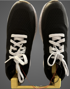

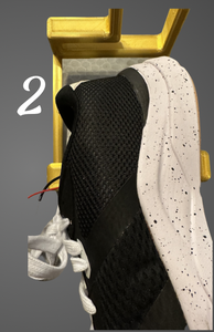

It is extremely difficult to attach the shoe to the stand without breaking the stand or causing any breaks in the shoe. First, I lay the shoe on the tallest part of the stand as shown above. Then I carefully and gently slide the shoe on it's side with the thinnest part (not the heel) so it is able to get over the ridge and be held in place properly. I then slowly and carefully twist the inner part of the shoe towards the stand until the shoe is in an upright position and balances on its own. I recommend attaching the shoe with the buttons on it first then the shoe with only the speaker on it.
Step 7: Wire the Last Speaker
Take the two wires you should have left out and solder them together to connect the other speaker. Please note this step is AFTER you assemble both speakers onto the stand.
Step 8: Secure Loose Wire to Stand
Tuck the loose wire (that's outside of your shoe connecting to the other) under the stand slightly and either tape or hot glue these into place.

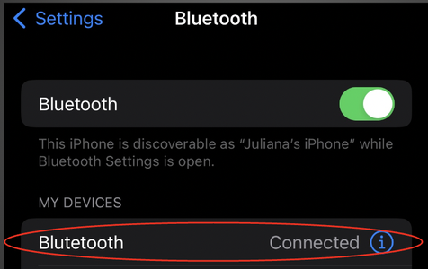

Turn on your phone, plug the speaker in and flip the switch on. The speaker should say, "Bluetooth mode" once it's on. Then, "the Bluetooth device is ready to pair". Once you've found the device (it should be called bluetooth on your phone) it will say "the Bluetooth device is connected successfully".
