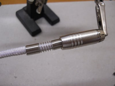

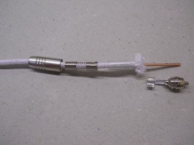

Step 4: Soldering the First Connector
Push the thread to clear about one inch of coaxial cable, then insert the accessories of the connector in the correct order. Double check the correct position of the accessories.
Take the lid of the coaxial cable close to the connector to measure the length of cover to be stripped.
After stripping the cover, twist the braid and tin it. Then cut the braid to be shorter than the tip of the inner conductor.
Now put the soldering iron tip under the metal tab so the heat can melt the tin of the braid. It is recommended to use a little more of soldering wire. DO NOT solder the inner connector yet.
Now push back the thread of the shoestring until it passes the metal tabs of the connector.
Using the pliers, bend the tabs in order to hold the thread together with the cable.
Now it's time to solder the inner conductor. If it has been done before bending the tabs, this would result in a tensioned wire, prone to break with normal use.
Push the isolator over the solder areas. Some connectors come with a therm-retractile isolator. If it's the case use a hot air gun to shrink it.
Now close the connector using the cover. This is the last time to correct any error in the position of the accessories.
Step 5: Soldering the Second Connector
Grab the cable right below the connector and using the thumb and the pointing finger stretch the shoestring thread, then cut it.
Now push back the thread and insert the accessories of the connector. Triple check this time. If you make some mistake in the position of the connectors you will have to cut the end and start it over.
The rest of the work is like the first connector.
