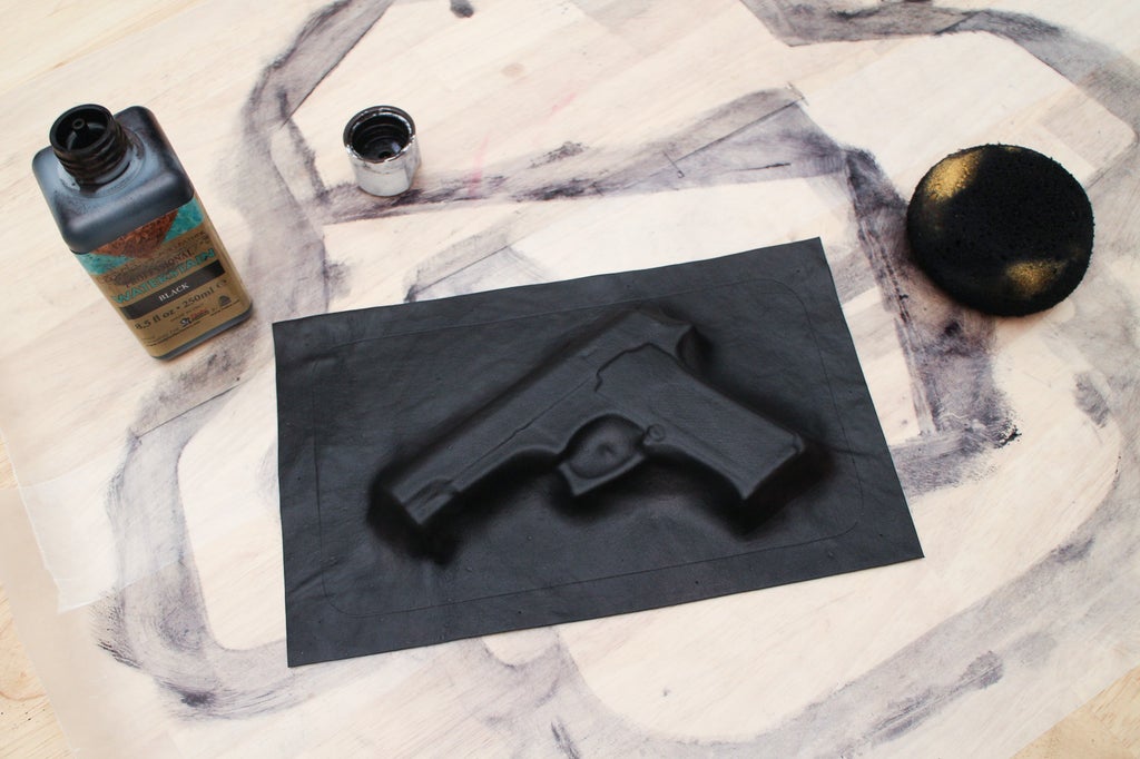

Step 8: Materials Experimentation: Leather
To further explore the capabilities and limitations of vacuum forming as a process for creating various commercial products we decided to try forming a very different material: leather. Veg tanned leather, when soaked in water can be sculpted and then dried to form reliefs that hold their shape. As well as being a practical sculptural material, we were interested in the idea of luxury inherent in leather as a cultural object, held in contrast to both the graphic and provocative nature of the subject matter, and the more synthetic nature of the plastic used in the light box project.
Using several types of leather, we performed experiments that tested the ability of the vacuum forming process to capture detail in wet leather.
We first soaked the leather in warm water, then draped it over objects in various materials positioned on the bed of the vacuum former. We then pulled sheets of thin heated plastic over both the leather and the forms beneath.
We found that using the vacuum former in this way did not effectively capture form and detail on either moulded plastic or plaster forms. In contrast, wet leather formed over objects by hand produced shapes with much more detail and allowed for much more control of the sculpting process.
More testing with different materials and forms will be needed to determine if an effective workflow can be developed for using the vacuum former to create sculpted leather forms. We are interested to try 3D printing forms that are specifically engineered with channels to control the air flow from the vacuum.

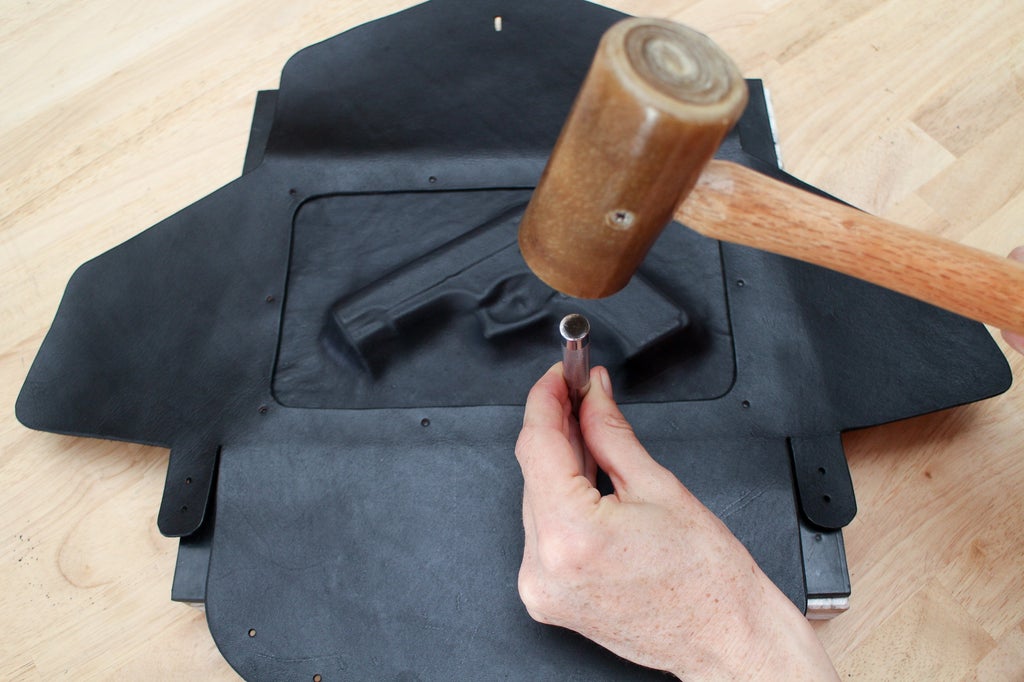

To create the design of the case I made a simple pattern for an envelope style clutch with a cut-out on one side where the moulded gun would be inserted. Leather that is best suited for moulding is thinner and softer than the leather that is a good choice for the body of a single layer clutch, so making the bag out of two materials was a good choice for this design.
I cut the pattern out in thick veg tanned leather, and used traditional leatherworking techniques such as gouging, beveling, edge burnishing, and dyeing, to finish the leather.
We cured the hand sculpted gun relief by I baking it in a 250 degree oven for 15 minutes, which set and hardened the shape very effectively.
I cut around the gun shape so it would fit as a insert in the cut-out window of the clutch, then sealed it with leather dye and finish.
I attached the two pieces with leather contact cement and quick set rivets, and assembled the rest of the clutch with rivets. I also added a stud button closure.
