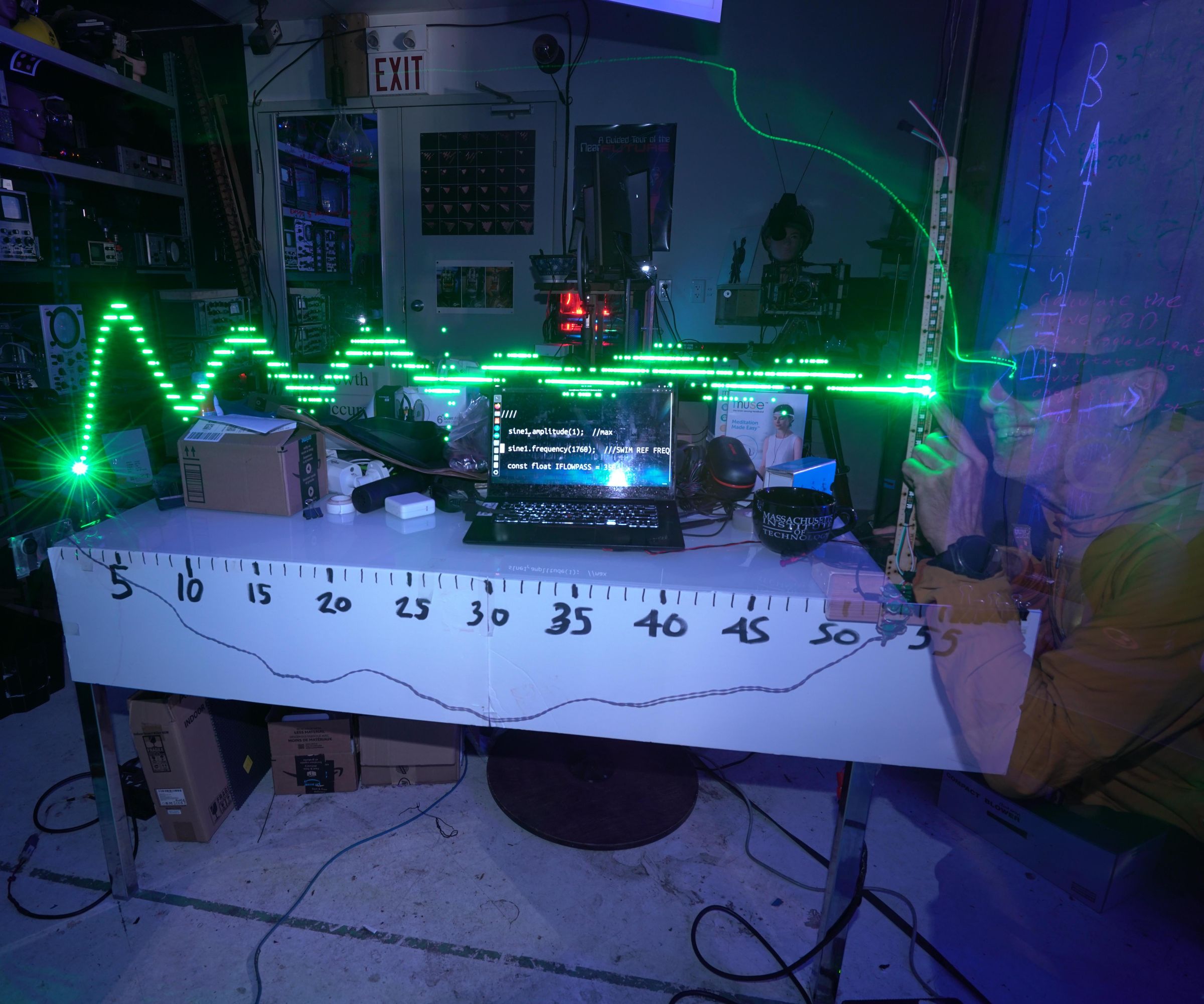

For the pictures in my last Instructable I glued a piece of black acrylic to my table, and then glued my breadboard to the acrylic. I also glued two desk lamps to the acrylic and glued one floor lamp to the floor to keep it stable. After completing the circuit on the breadboard I pried the glue away so that I could wave the breadboard back and forth and show the radio waves as an augmented reality overlay.
The human eye does a really good job of integrating light, so that when you wave something back and forth the eye can see it nicely. But many cameras do a poor job of capturing a true and accurate rendition of what the eye sees.
If your project produces light, you have a really great opportunity to make it really shine, by using multiple exposures to capture the project the way the human eye perceives it. In my case I took a set of pictures in ambient light, which I named as filenames like a1.jpg, a2.jpg, a3.jpg, etc. (a sequence of images shot with ambient light). Then I shot another sequence of images in the dark, with longer exposures, to show light trails the same way that the eye sees them. I labeled these h1.jpg, h2.jpg, h3.jpg, ... for "head", and t1.jpg, t2.jpg, t3.jpg, etc., for "tail". The above example shows three ambient light images in the top row, three "heads" in the middle row, and three "CEMENTs" in the bottom row. Each CEMENTs was made by CEMENTing the two images above it.

Over the years I've found that pixel count (more megapixels) matters less than dynamic range, the range of lightspace, and lighting in general. My HDR eye glass only run at NTSC resolution, yet allow me to see better than most cameras, owing to a dynamic range of more than 100,000,000:1, even though the pixel count is not too high.
The best way to get control over exposures is to use multiple exposures, and manage each exposure separately. When shooting something that has LED lights on it, or a video display, or TV screen, for example, one shot taken with flash or ambient light, and another taken without flash or without the ambient light (e.g. in the dark) can be combined using the Computer Enhanced Multiple Exposure Numerical Technique (CEMENT) that I invented for combining multiple differently illuminated pictures of the same scene or subject matter.
Above you can see examples of pictures I took with a 4-hour long exposure, and a ten-year-long exposure, using CEMENT (HDR with 9 exposure brackets every 2 minutes for 10 years).
