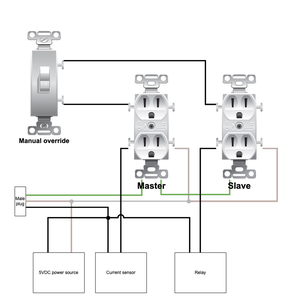

Step 3: AC Wiring
First prepare the 5VDC power source, solder a pair of 18 gage wires to the inlet of the wall adapter and protect the connections with shrink tubing or electrical tape, cut the phone connector and peele the end of the wires, mark the positive one.
Make sure the N wire of the enclosure's inlet is connected to the N of both slave outlets, master outlets and to the 5VDC power source. Also make sure the GND wire of the inlet is connected to both grounds of every outlets and to the metal case. The L wire of the inlet needs to be split into 3 wires: one will go to the current sensor, one to the relay and one to the 5VDC power source.
A wire needs to come out of the master outlet's L, later on we will connect it to the current sensor
And a wire needs to come out of the slave outlet's L, it will be connected to the relay.
I used the existing rocker switch to add a feature: manual override. It will allow me to turn on the slave outlet manually whenever I need it. It is connected in parallel with the relay.

According to the datasheet, the current sensor ACS712C outputs 100mV/A having VCC/2 representing 0A.
Since we are working with Alternating Current (AC), and VCC is supposed to be 5V, the sensor will give us a 60Hz sine-wave voltage centered on 2.5V with an amplitude proportional to the current drawn by the master appliance.
To be able to convert that signal into an action we need a few steps:
- compare the voltage with a reference, for that we will use the comparator MAX901 and the reference will be given by a variable voltage divider (a potentiometer). The output of the comparator will be 0V when no current sensed and a 5V 60Hz square wave otherwise;
- convert the square wave into an almost-linear curve using a first order RC filter;
- smoothen even more the "almost-linear curve" with a second order RC filter;
- negate the signal with a NPN transistor (NOT function) because the relay module is active when it's input is low (0V).
I have set quite high RC values intentionally because they are going to perform a desired effect: a delay. In this situation, the relay activates a bit more than a second after a current is sensed, and it deactivates the same amount of time after no current is sensed.
Think about when you turn on a powerful machine such as a table saw, during the time the blade goes up to speed it draws the full amount of power. It is better to wait for the blade speed to settle, and the consumption to go down before starting up a second heavy engine like the shop vac, this way you reduce the chance of overloading your AC circuit.
And, when we turn off the table saw, it is preferable to have the shop vac working a bit more time to suck all the remaining dust.
