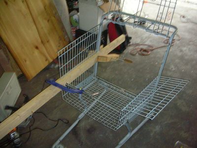

Step 3: Arms!
To make the arms, find the bar (running perpendicular to the handle/back) that is approximately halfway up the sides of the basket. Clamp two pieces of wood sandwiching each side of the basket and aligned with that meridian bar. It may be helpful to flip the back up (the mechanism by which the carts nest.) Leaving the back that way means you could eventually nest several chairs together just like they store them at the supermarket.
Use the grinder to snip the two welds that fasten the basket sides to the back frame, cutting only down to where the wood has been clamped. All carts are different, so look and cut carefully. You don't want the sides completely detached from the back, only halfway detached, to maintain some rigidity.
Then just bend the sides of the basket over. The clamped wood just provides some resistance at the bend, so as to make a clean crease.
