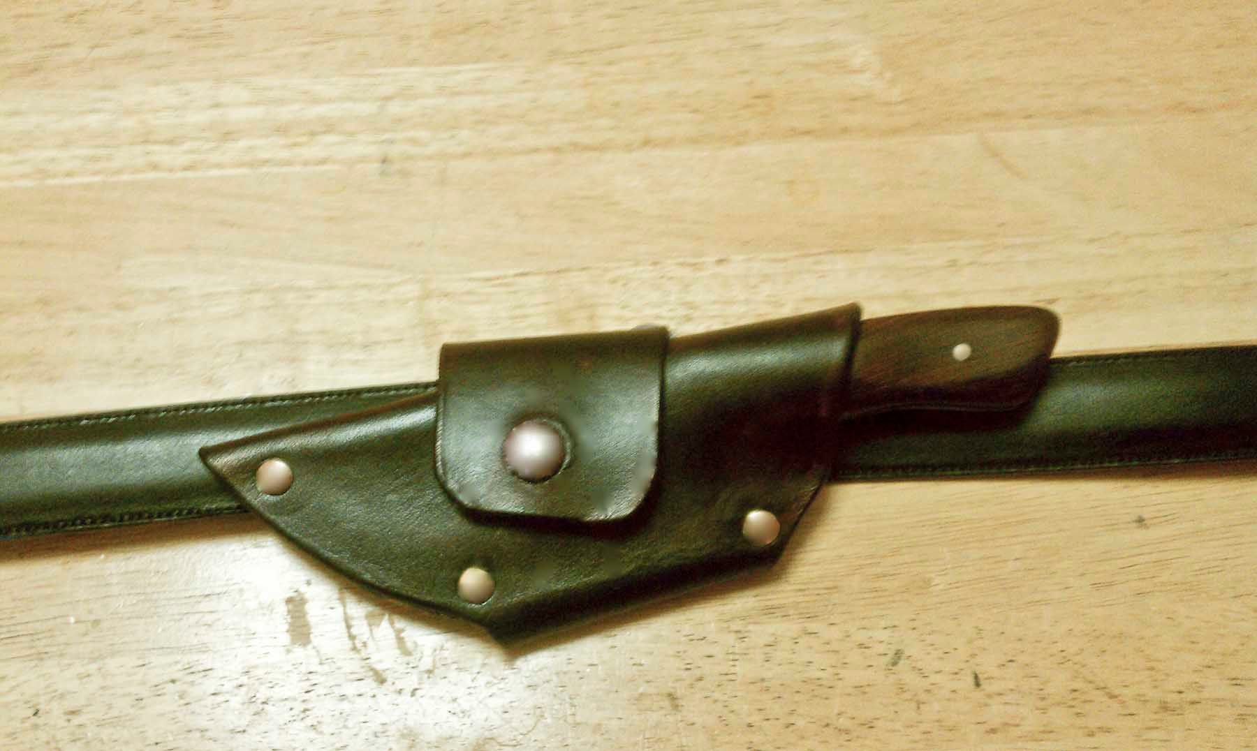

I started with a piece of 3/16 x 1 x 4 3/4" high carbon steel, 1084 to be exact. The resulting knife is 7" long with a 3" blade. The handle material in this case was Horse stall mat with carbon fiber pin and lanyard tube. Sheath was handcrafted from Herman Oak leather, oiled and coated with Aussie to protect it from the weather.
