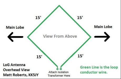

Also, I will use equal conditions (antenna) for both receivers, which in this case is a home-made "Loop on Ground Antenna" LoG , which I made according to the instructions of Matt Roberts (KK5JY.net),immediately after purchasing the radio. I want to say just a few words about this wonderful antenna.
 My home is located in a less-than-friendly RF environment surrounded by large buildings on all sides, but luckily I have a small yard where I placed the 15 feet square antenna right around the trunk of a large tree, installed directly on the surface. I still can't believe how good features has this antenna. First of all, the construction time is less than an hour, and from the material, you need any insulated wire of suitable length. I have installed several types of antennas on my roof, including Mini Whip, long wire antenna with antenna tuner, small loop active antenna, but the last LoG antenna is definitely my favorite. The signal-to-noise ratio is simply amazing, thanks to the fact that there are no active signal amplification components. With this antenna, I receive signals that I couldn't even think about until now, so I especially recommend you, if you have a little yard space, to try it.
