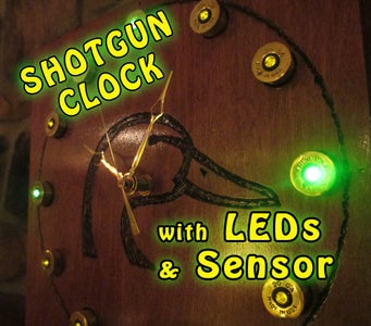

Introduction: Shotgun Shell Light Sensor Clock
Learn how to make a beautiful wall or mantel clock that any Waterfowler would love to add to their sportsman decor.
In this Instructable I will show how to use some basic Woodworking skills, beginner Wood Burning, and amateur Electronic work to build a working IR Light Sensor Circuit triggered clock. That's right, this clock lights up automatically in the Dark!
To date, I may have the only 2 Shotgun Shell Clocks on Instructables. I have seen them on other sites, but not how to make them.
Considering all the different skill sets embedded in this documentation I have to pat myself on the back. Pretty proud of myself especially with solving my desired Light Sensor function of the clock.
I hope this Instructable inspires others to add some sportsman decor to your home. Or at the very least, make a gift for a deserving sportsman.
Read on and enjoy!
