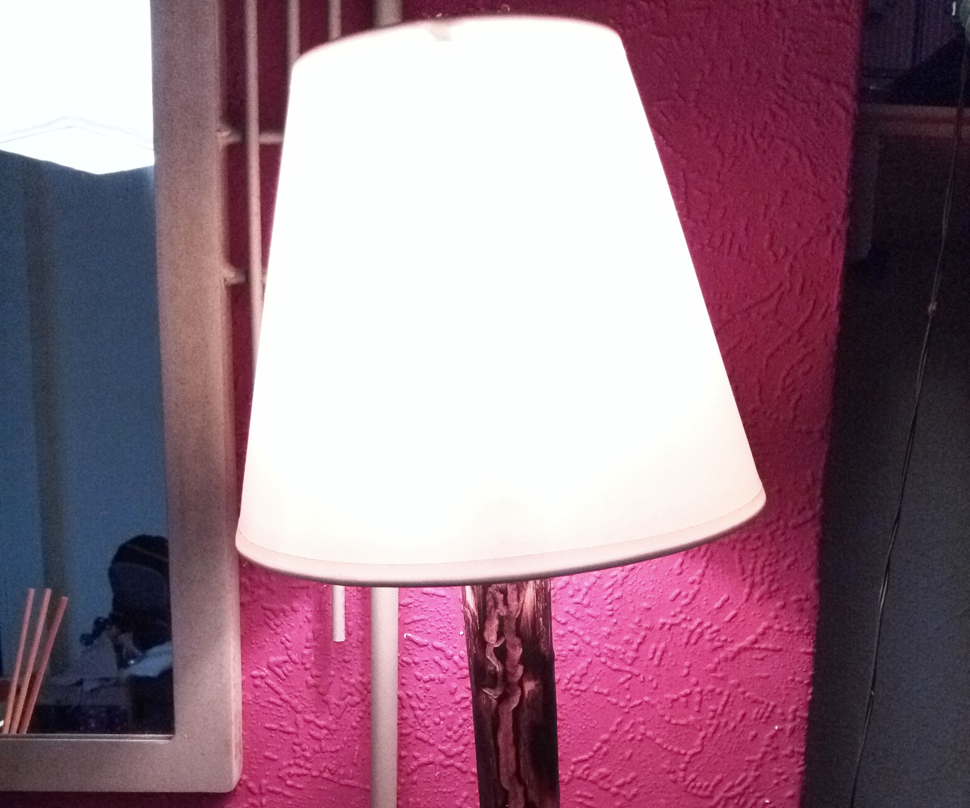

Step 10: Plug It In
Plug it in, switch it on and enjoy!
