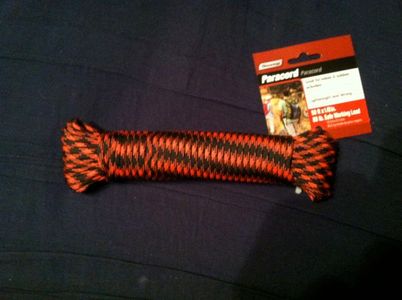

A minimum of 6 feet of paracord

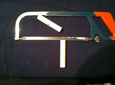

1 - hacksaw or chop saw to cut the PVC.

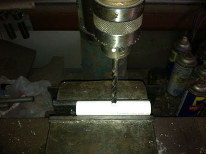

1 - electric drill & ¼ inch bit to drill a hole through the PVC.

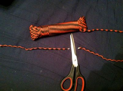

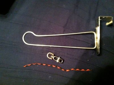

Cut off a 6 inch piece of paracord and burn or tape the ends so it will not fray out. You will still have 5½ feet left.

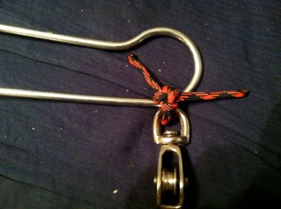

Attach the pulley to the clothes hanger with the short piece of paracord as shown in photo
Pass the long piece of paracord through the pulley with the two ends hanging down

Cut the PVC into two 4½ inch pieces with the hacksaw
Drill ¼ inch holes through the center of the 2 PVC pieces

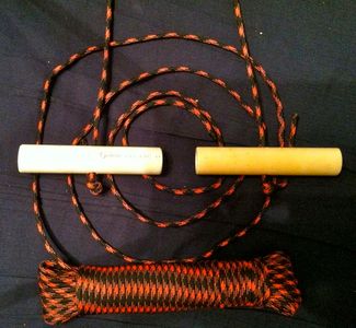

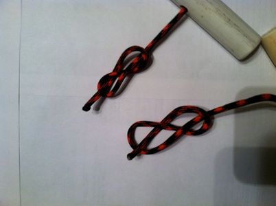

Thread the ends of the paracord through the holes in the PVC & tie figure 8 knots in the ends
This animated site will help you tie the figure 8 knot: http://www.animatedknots.com/fig8_/
BTW: That is a VERY good knot and really holds securely. I have used it for years.
