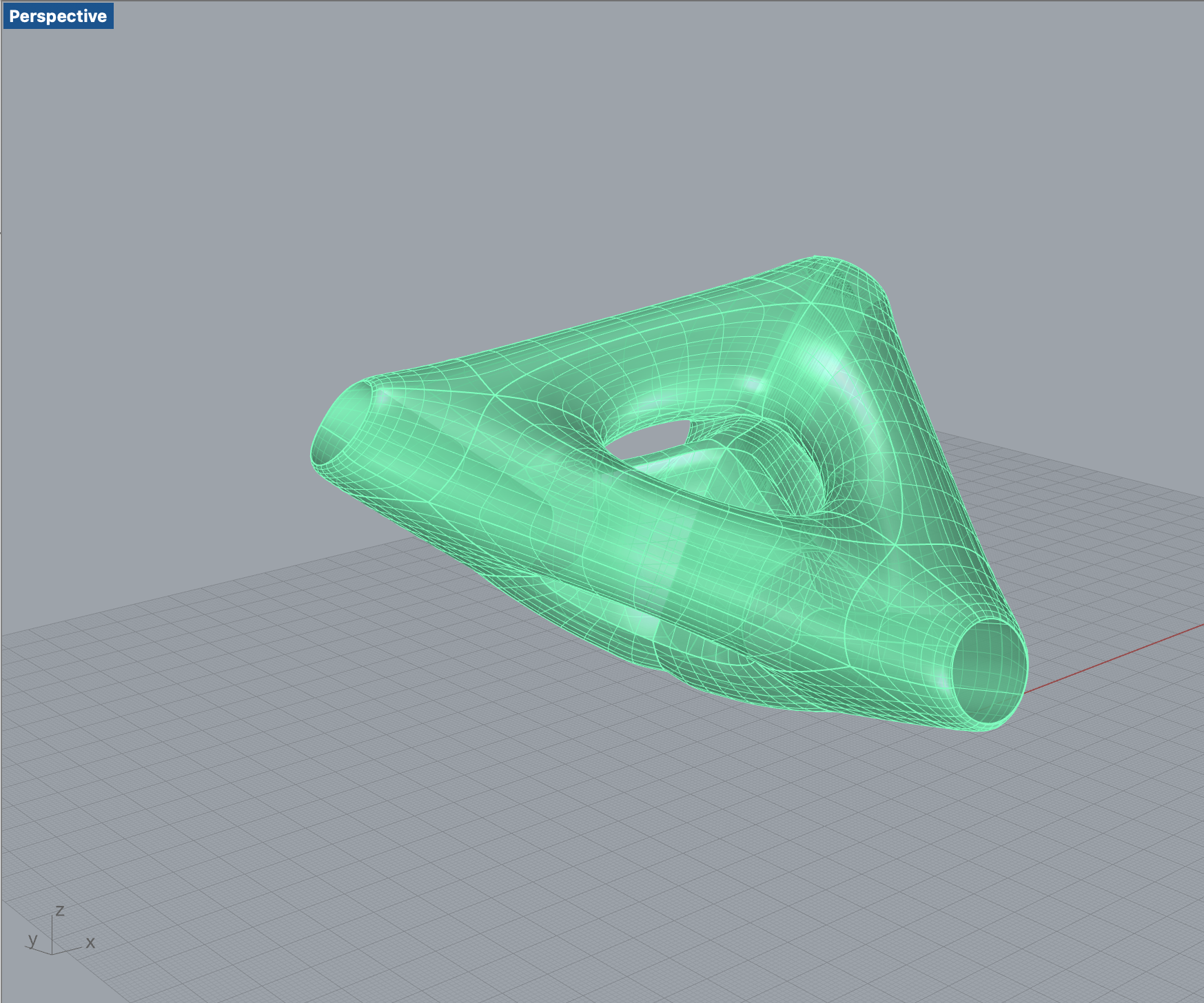

I mainly used Rhino Standard design for every 3D printed piece. I first built the models, then started printing them. It was a long process. Then, when I got the pieces, I will first sand them, because some of them were a little bit coarse. Then I spray lacquered them, based on my personal color preference. Then I put some wood wax on the wood parts, to give a better look.

The process went well, except the printed connecting joints weren't the exact size I wanted them to be, so I got to put some tapes on the sticks, so they will fit in the hole.
