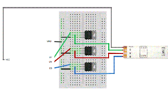

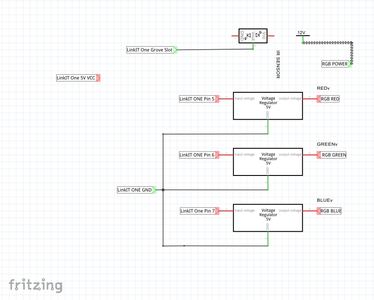

Step 2: Building the LED Strip Circuit
First, let's get our LED strip lights up and running. This is probably the more complicated circuit. in terms of what is actually going, but fairly easy to actually put together. It's pretty simple to put together on a breadboard. If you're actually deploying though, you can solder it together with a protoboard for a cleaner and more polished look.
I've attached both a visual diagram using a breadboard, and a more standard schematic.
An important Note: Unlike the Arduino, the LinkIT ONE only has 2 PWM pins. These PWM pins allow the RGB LED to fade and change colors on the fly. Since I'll just be flashing a color, I elected to just forgo the PWM pins all together.

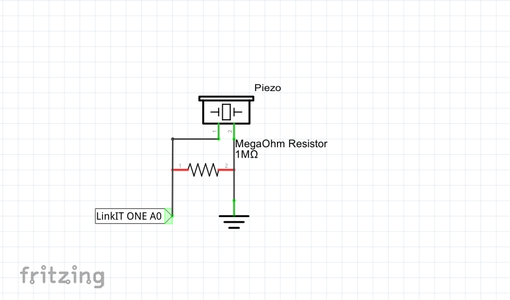

Step 3: Building the Piezo Circuit
Next up, let's handle the circuit for the piezo element. The piezo element will help us detect knocks on the door. It's basically a little electronic sensor that can detect vibrations, so it will work perfectly here.
An important little fun fact about Piezo elements is that they are polarized. This means that the voltage passes through in a specific direction (instead of just bouncing either way). Piezo elements usually come with a specific red wire and black wire, pay close attention to the color of the wires! Black must be hooked up to the lower voltage, and red to the higher voltage. IF you don't follow these instructions, you might just burn our your Piezo! That's no good!
Piezo elements are best measured with an analog signal, so connecting them to A0 (an analog pin) on our LinkIT ONE will work best.
Also, we should connect a 1-mega ohm resistor between the Piezo element circuit. This limits the voltage and current produced and protect it from frying our LinkIT ONE board.

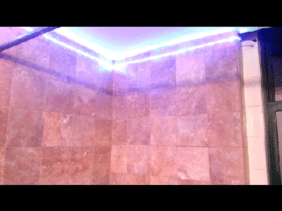

Step 4: Deploying the Lights
I found a good spot for my lights to be up above the shower. Very little water got up there, and it still stuck pretty well to the tile. Just for added effect, I decided to go a little bit further around the bathroom as well.
Make sure that the lights are low enough so the person in the shower can see them, but high enough to stay away from high moisture areas. I know this is a bit difficult in a bathroom, but do your best!
