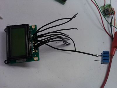

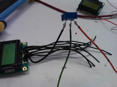

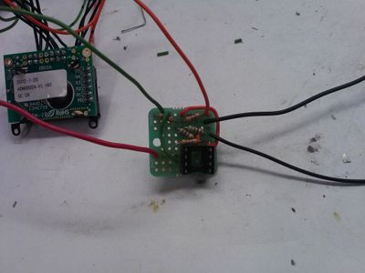

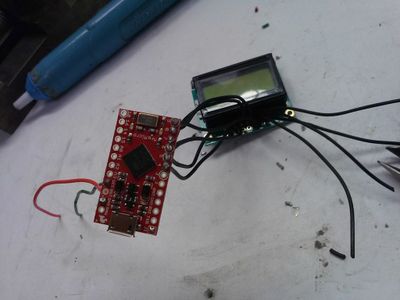

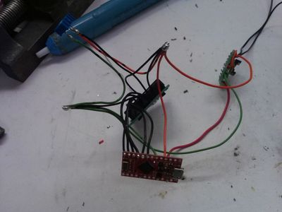

Step 1: Circuitry
For the circuitry we started by using a large breadboard, then a smaller breadboard, and then finally a small protoboard. Our design comes from this instructable by stacey K. We took the original idea and tried it out on a large breadboard, and then got smaller and smaller until we were able to fit all into the 1" square protoboard.

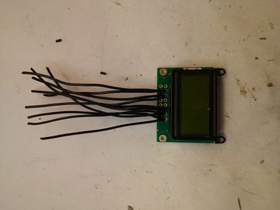

For the connections from the arduino and the potentiometer to the LCD display we followed this Instructable's directions.
Pin 1 to GND
Pin 2 to 5V
Pin 3 to wiper
Pin 4 to Arduino pin 12
Pin 5 to GND
Pin 6 to Arduino pin 11
Pin 11 to Arduino pin 5
Pin 12 to pin 4
Pin 13 to pin 3
Pin 14 to pin 2
(Connecting an LCD to the Arduino by crocboy)
Instead of using a wiper, we had Pin 3 connect to the potentiometer.
When you are connecting the battery to the protoboard, you'll need to cut off the connector so you can solder the wires directly into the protoboard.
After all of the circuitry was soldered, we soldered the LCD display and the Arduino, as well as the straided wire (that had gone through the case, and was attached to the molded piezo) to the circuitry board.

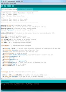

Step 2: Code
Lots of testing and re-checking happened to make the code what it is right now. Things might work differently for your plumbing systems or if you use different equipment throughout the process. This code worked for our project using the equipment and methods that we used.
The picture is purely for demonstration. Image source http://apcmag.com/arduino-masterclass-part-3-tv-w...
For this specific code we downloaded multiple 'libraries' of how to program an arduino to our computers.
Software for Calibrating the Arduino
Fill 5-gallon bucket with water and read off the number on the screen. Divide this number by 5 and you have your conversion factor (con)
