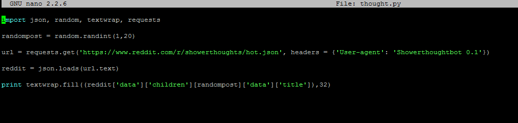

First we need to create the program. In terminal type in sudo nano thought.py, then paste in this code and save by pressing ctrl-x
import json, random, textwrap, requests
randompost = random.randint(1,20)
url = requests.get('https://www.reddit.com/r/showerthoughts/hot.json', headers = {'User-agent': 'Showerthoughtbot 0.1'})
reddit = json.loads(url.text)
print textwrap.fill((reddit['data']['children'][randompost]['data']['title']),32)

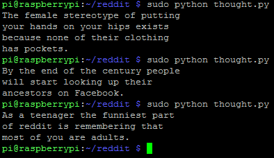

To run the code in terminal type in sudo python thought.py

Then we display the post. We want the title of the post. We use textwrap so that after 32 characters it starts a new line.I picked 32 so the text doesnt scroll too far in the screen. Depending on how you display this you may need to adjust it.
