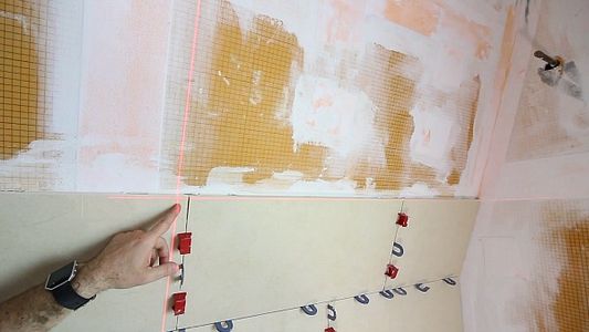

Here’s the Bosch laser level Steve recommends.
It’s not cheap at $129 (the Bosch model number is GLL 3-15).
But let me tell you, it’ll make your shower tile look 100% better than if you eyed it up.
Plus, it won’t smudge…unlike a pencil mark or chalk-line.
The Bosch model here shoots both a vertical and horizontal laser across the wall.
So you can line up the vertical tile joints with each other as you move across the shower wall.

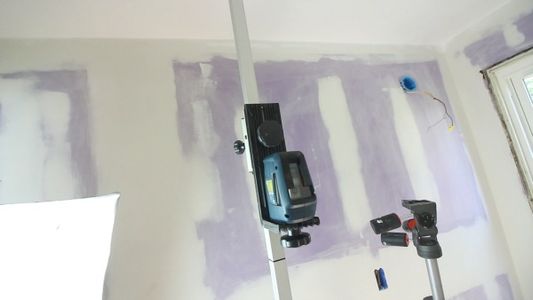

But how do you keep the laser still while working?
Step 2: Introducing the Laser Jamb
The first time I saw Steve use this tool I was like ‘what the heck is that?’.
After he explained how to use the Laser Jamb I was super impressed.
What a cool idea.
Basically you attach the laser level to the jamb and place it anywhere in the room.
How does it work?
Simple, it has two feet. One is on the floor and the other on the ceiling. It uses pressure to hold itself in place.
Then you can slide the laser up and down the metal framing.
Pretty awesome!! The picture above could be better but the bathroom was small, like Willy Wonka small (whatever that means).

Attention to detail is everything when tiling and Tuscan SeamClips help you stay on track.
These little clips slide behind the tiles. And when you use them they help clamp the tile to the wall.
Furthermore, the SeamClips compress the tile into the thin-set and create a smooth transition from tile to tile…which eliminates tile lippage.
Lippage is simply when two adjacent tiles are even.
Position SeamClips 2-3 inches from the edge of the tile and every 6 to 10 inches along the tile.
You’ll need to know the thickness of your tile before purchasing SeamClips.
They come in Red, White or Blue. Each color represents a different size SeamClip. We used Red SeamClips in this tutorial because the porcelain tiles were 3/8″ thick.
Some people say you don’t need a leveling system like SeamClips if you’re a good tile setter. But honestly, wouldn’t you want to give yourself every advantage when tiling?
Plus how often are you going to tile your shower or floor? Once every 20-30 years.
Personally I find them to be very useful but you can decide for yourself.
Now, SeamClips are great at leveling tiles but they’re only 1/32″ wide.
Therefore you’ll need a spacer for properly sized grout joints. Horseshoe shims are great for this.
They’re made from plastic and come in different thicknesses.
The horseshoe shims are in between the SeamClips in the picture.
Placing them at tile transitions, for example where three tiles meet, helps keep grout joints nice and even.
We recommend getting 1/16″ horseshoe shims.
That way you can use them in 1/16″ increments to get the grout joint you need or to shim tiles up off the tub.
