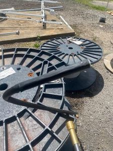

Step 1: Observe Cable
Make sure that cable feeder is clean.

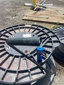

Step 2: Shrinkwrap
Make sure that shrink-wrap is secured over cable.

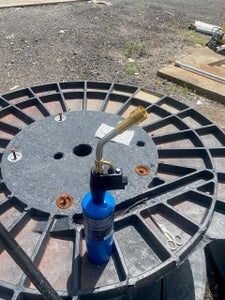

Step 3: Torch Assembly
Make sure that torch head is screwed onto propane tank tightly.

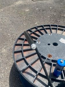

Step 4: Shrink Cable
Final step is the press button on torch to allow flames to melt shrink wrap. Move torch in a horizontal motion shrinking full feeder.

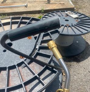

Step 5: Finished Product
Finished product. The cable is fully shrunk and protected from rain and inclimate weather.
