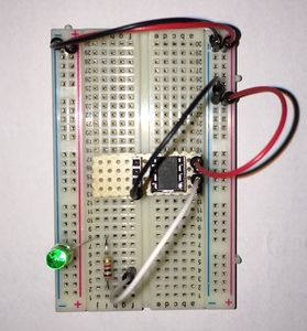

Step 4: Hook Up the Programmer HW
I've created a small board for the ATtiny85 as shown above, using a piece of stripboard, an IC socket and two header sockets. It can be used for a project or for programming the AVR too.
After cutting the stripes (red arrow), check with a multimeter in continuity test mode that there are no shorts.
Color-coding the connections and using a visual reference helps a lot! Hence the hand-drawn figure and the jumper cables with different colors.
Do not connect the Arduino to your computer yet. First make the connections, make sure that they are correct. Finally if all is OK, then connect the Arduino to your computer.
You're good to go to the last step, where you actually program the AVR.
