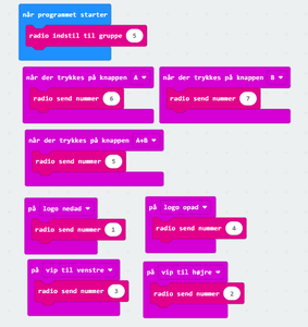

Step 9: Sample Program
Since I wanted to control my robot with another microbit I wrote a simple program. (I am sorry that it is in danish)
First I went to makecode.org and programmed the sending microbit.
I assigned it a radiogroup and programmed it to send different numbers based on the angle I held the microbot and if I pushed the a or b button.
Then I programmed the resiving microbot that is on the robot.
First I went down to extensions and found the motorbit extension. Then I assigned it to the same radiogroup as the sender and made it do different actions depending on the number that was send to it.
You can find the two programs linked bellow.
Sender
Resiver
Step 10: Claw Robot
I then downloaded the two programs to my two microbit and the claw robot was finished.
