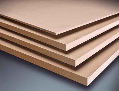

  1. Plywood. (12mm thinckness).

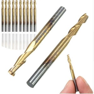

We will also need a CNC machine and we will use 1/8" two flute CNC bit.

Also, you can find the bit settings.
Note: always start by making the cutting profiles for the inner shapes and the cut the outer.
