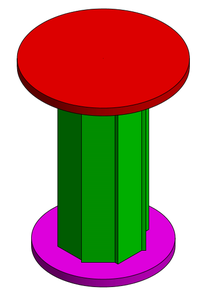

Step 2: Drawing
You will be building to this drawing.

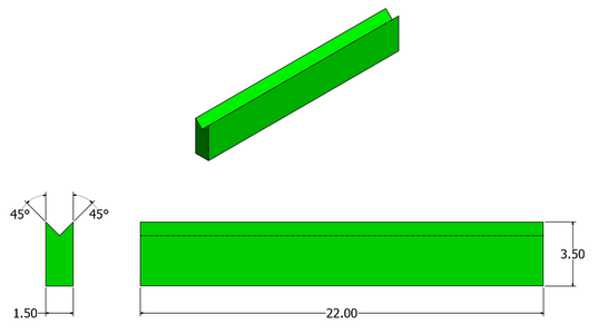

Step 3: V-Notch for Sides
You will first cut the V-Notch into the 2x4s. It was easier for me to work with shorter boards so I cut the 2x4s to 48” long. Set the table saw blade angle to 45 degrees and move the rip fence so it just clears the blade. At this point you might want to experiment with scrap wood until the blade height makes a perfect V. Make two passes to complete the notch. Repeat this process for all four 48” sections.
Step 4: Sides to Length
Cut the 2x4s to the desired length. I wanted a 24” tall stand so the side segments are each 22” long. You will need eight sides to complete the pillar. Depending on your cuts, you might have a little material in the center of the groove. If so, clean up any rough spots with sand paper.

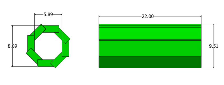

Step 6: Fit Check
Do a fit check at this point. If everything was cut correctly, you have a nice octagon shape.
Step 7: Assemble Pillar - 1
Add a liberal bead of glue down the center of the notch of each of the eight sides.
Step 8: Assemble Pillar - 2
Four of the pieces should have pocket-holes drilled in them. Assemble in an alternate manner so four screw locations are across from one another. Use ratchet straps to pull the pieces together. I only used two but additional ones would apply more pressure and make tighter joints.
Step 9: Assemble Pillar - 3
You now have a complete pillar. Sand to remove any blemishes and break sharp edges

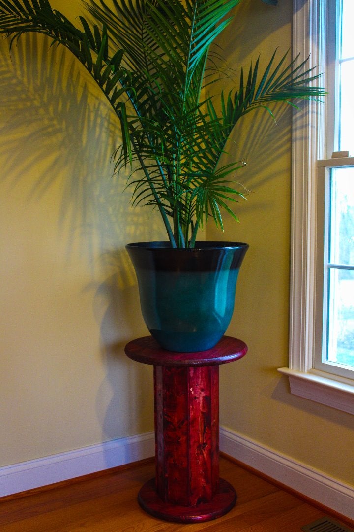

Step 14: Finished Table
Step 15: Plant Stand
