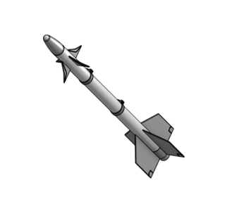

Step 1: Designing

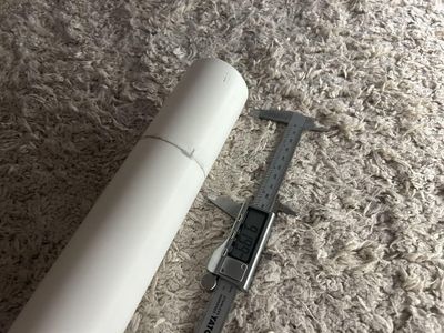

Designing process:

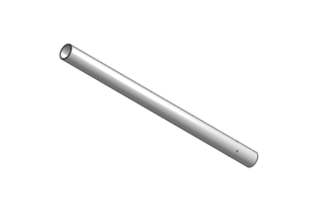

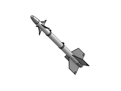

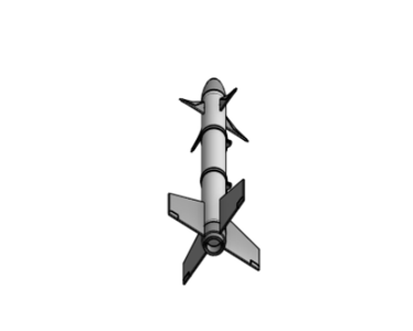

I started designing this model by creating a model of the PVC pipe I had. Its outer diameter is 60 mm, and the walls are 2 mm thick. For the whole process, I used the OnShape web-based CAD. The next steps involved designing the other parts of the missile around the model of the PVC pipe. The attached photos show the final outcome of my work.

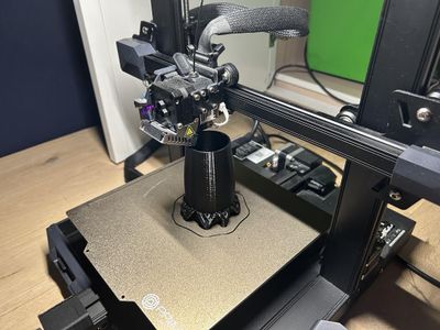

Step 2: 3D Printing
3D Printing Instructions:
I recommend using PLA for all of the parts except the clamps, which can be printed in PETG for better flexibility. Print 4 of the lower flaps, 4 of the upper flaps, 2 clamps, and one of each remaining part. Use 10%–20% infill, and make sure to follow the instructions provided by your filament's manufacturer.
Step 3: Prepairing the PVC Pipe
Drilling and Sanding:

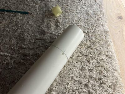

While the parts are being printed, holes for the upper flaps can be drilled into the PVC pipe. The 4 holes should be placed along a line 92 mm from the end of the pipe, with equal distances between them. Next, sand the tips of the pipe smooth to ensure a good fit with the 3D printed parts.
