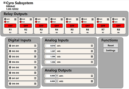

  9. Once installed, launch the SigCore Control Panel from the Start Menu or desktop shortcut.
  10. If the device is connected properly, you should see the main window populate with relay states, analog input readings, and digital inputs.
💡 Tip: If nothing appears, double-check the USB connection and ensure the unit is fully booted (green LED solid).
Step 3: Read a Sensor and Toggle a Relay
To Read an Analog Sensor:
  1. Connect your sensor’s output to one of the Analog Input terminals (AI1–AI4).
  2. For example, connect a 0–10V signal source or a 4–20 mA loop if your sensor supports it.
  3. In the Control Panel, look for the Analog Input section.
  4. The corresponding channel will display a real-time voltage or calibrated value (depending on configuration).
🧪 Example: A 0–5V temperature sensor might show 2.5V in AI1.
To Toggle a Relay Output:
  1. In the Relay Outputs section, locate the relay you want to control (R1–R8).
  2. Click the ON/OFF toggle button next to that relay.
  3. You’ll hear a click as the relay switches — and the LED indicator next to it will change state.
