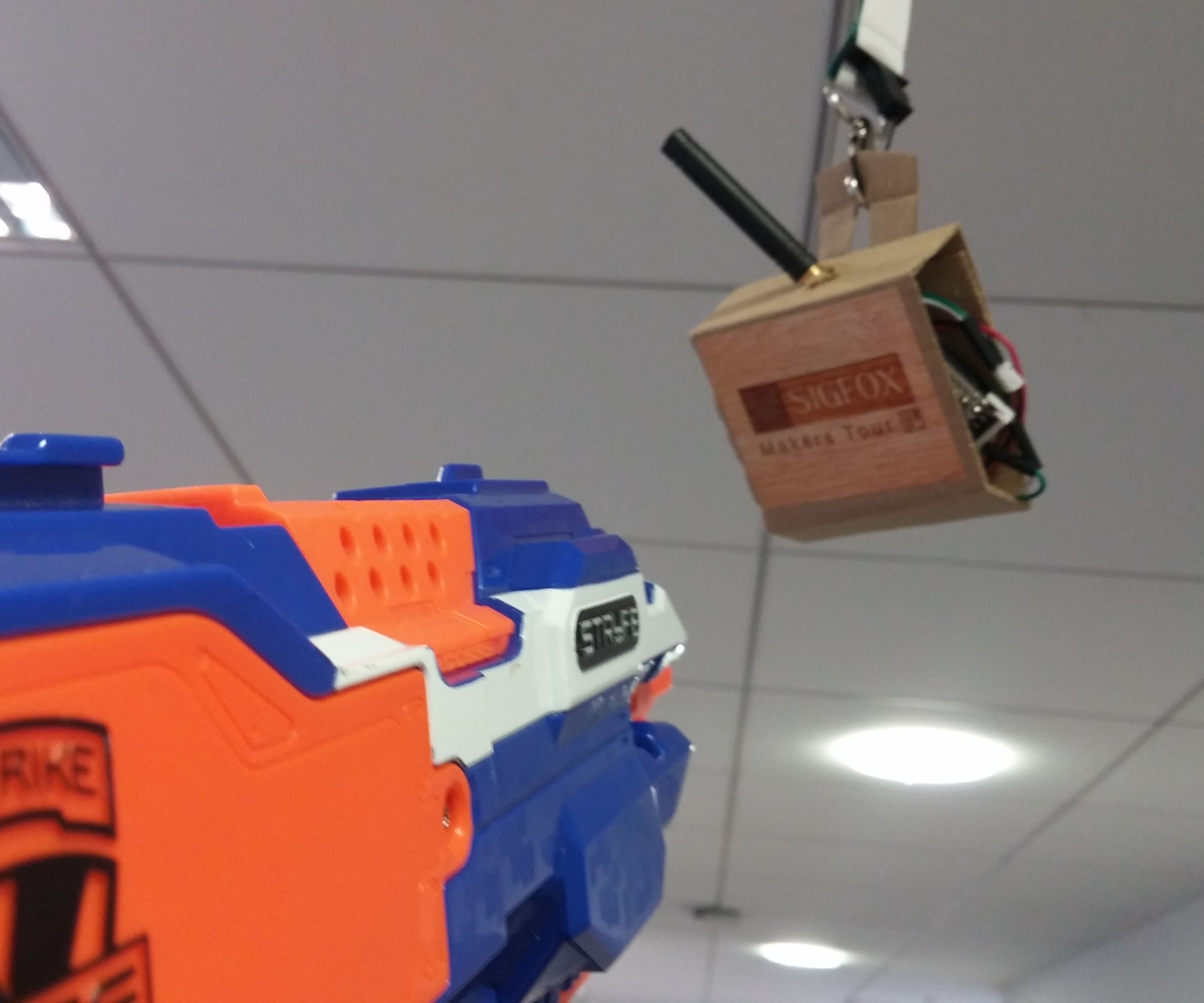

Step 5: Make the Target
This step is completely up to you.
I decided to make the target using some carton lunch box but you can use whatever support you want.

Now everything is set up and you can shoot the connected target!!
