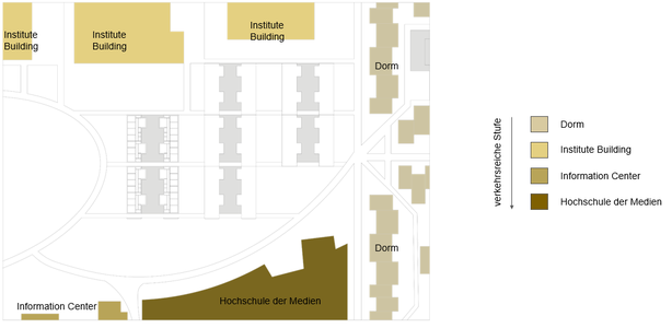

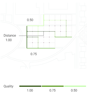

Step 3: SITE ANALYSIS —— Privacy
We have analyzed the building around this dormitory, and the road around it. By creating a level to evaluate the privacy condition in this area, the basic information about privacy conditions can be seen from the pictures.

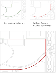

Step 4: SITE ANALYSIS —— Views
The good point of this location is that this place is surrounded by a nice garden. As privacy to the inside is so important, the view form the outside is also considered as an important point.

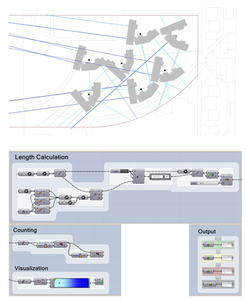

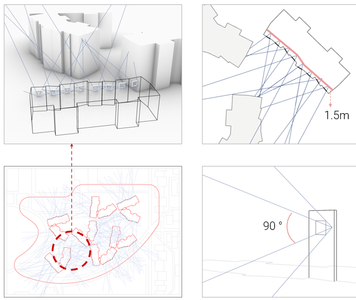

For the design part, we follow the design principle from the original design, using algorism to optimize the sight condition for each room and try to ensure that the new design will have the same amount of room as the old design.
In principle, our design is based on the urban scale and building scale.
The urban scale is for the unit position, angle, and height, and the building scale is for the detail of every building window’s orientation.

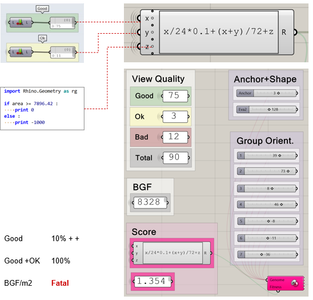

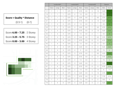

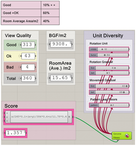

The second step about urban scale design are height design. With different height condition the sight view about each building will also be different. According to the beautiful view around the site. We are analysing the view in each area on the site. Then create a grid to evaluate it based on the view condition on each area. In order to get the better views for each building. We can use the height change to let more rooms get the good view, not just the one near the garden.
Step 8: GROUP SHAPE & ORIENTATION
the degree of each unit will have diversity change. Then the evaluation will be based on the anchor position change and the unit degree change, to find the longest sight distance for every building in the site.

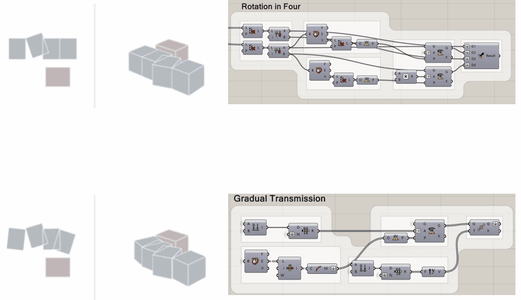

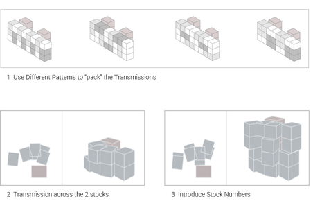

Then after we decide the urban scale design, we are now goes in to more detail about the unit design. At the original design, each unit have two buildings, and they are using the same staircase. Each floor has 8 rooms in total. So, in this dormitory, it’s all 4er WG. We have followed those rules, also set one floor with 8 rooms. And each 4 rooms have a shared bathroom and the kitchen.
The point about our design is mainly about to change the orientation of each room, so that it will not have a direct eye contact in between rooms and room with outside roads. In this way, people will feel safe to live in it.

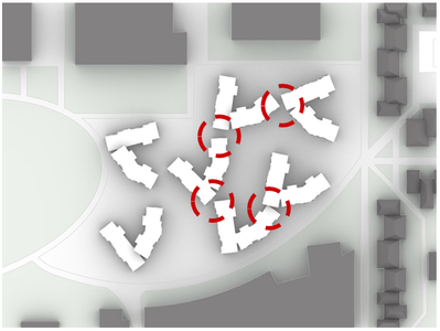

Step 10: ADJUSTMENT & CONNECTION
After the complexity orientation of the building and the room. There are always edges that not suitable for living. At the last step, we manually connect the hard edge in between those buildings.
