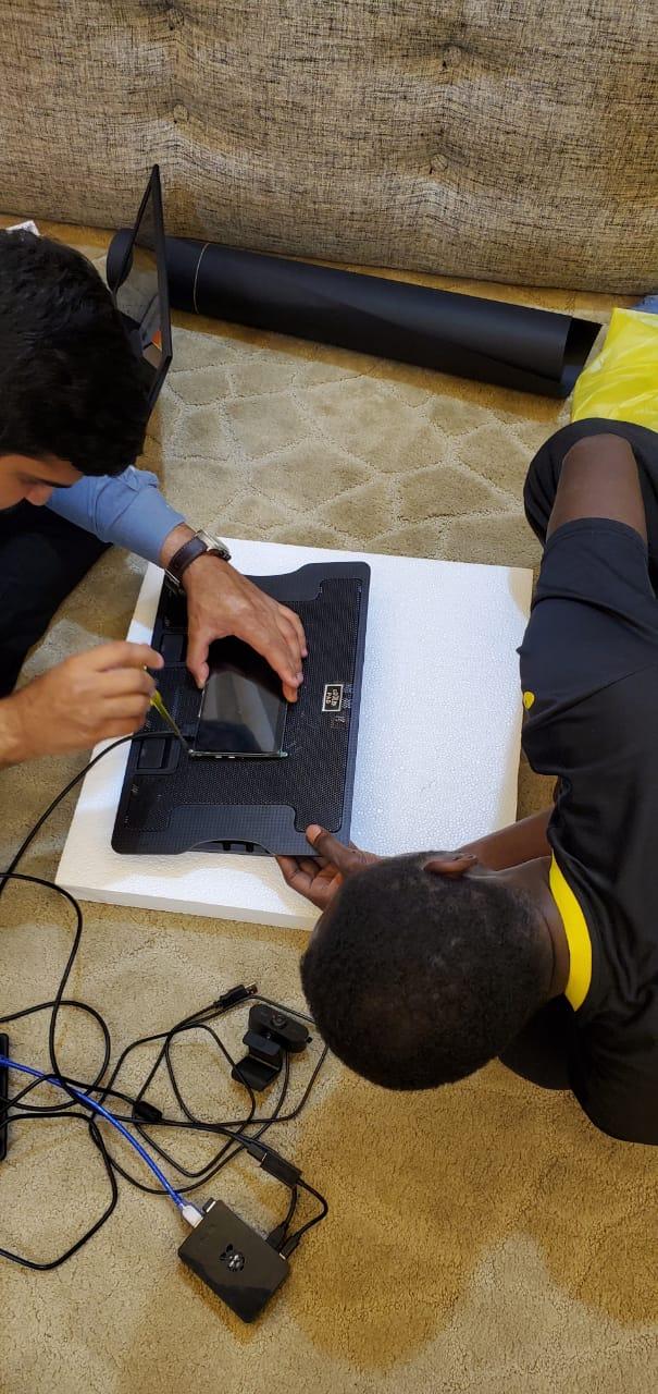

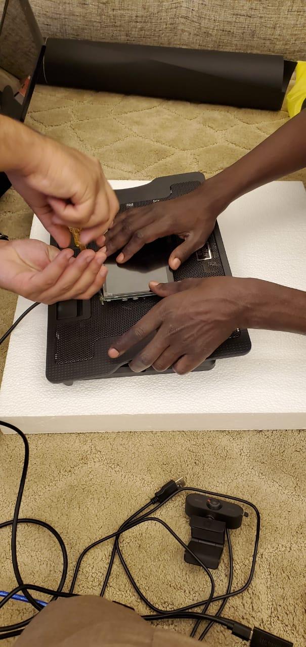

Step 6: Assembly and Final Design
After making sure that the project works well, we connect the project parts together and make the final design of the project.
