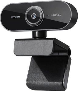

For these project I have used the RasperryPi 5 with the Freenove Kit for RaspberryPi 5. I have also used an webcam for tracking my hand. A good light source is always welcome :)

  • Webcam (720p-1080p)

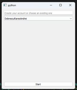

Step 1: Creating My Own Application for Taking Pictures
First we need to make an application that takes pictures of our hands. You can also use an dataset from internet but I wanted to make my own dataset that I can use for my project.
After taking the picture and saving it, the data will be automatically transferred to a folder with the name of the gesture and the hand. This data will of course be in a CSV file.
I want to mention that I also worked with a MNIST dataset from the Kaggle application and everything went very well, but with all that I wanted my prototype to work only with the pictures I took.
