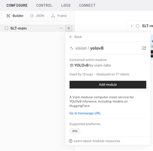

Now's the moment to integrate computer vision into the system by setting up the vision service for the machine.
While Viam's default mlmodel vision service is compatible with Tensor Flow Lite models, this project employs a YOLOv8 model. To achieve this, we'll utilize a module from the modular resource registry designed to enhance Viam with YOLOv8 integration.
With the YOLOv8 module, we have gain the capability to leverage any YOLOv8 model seamlessly to the Viam machines.
We have used a yolov8 model from the hugging face that is capable of reading the 26 letters of American sign language alphabets.
