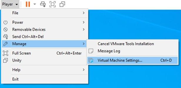

  • (9) This idea is about the same as #7, but “semi-virtualized”: Just run the (second) application not on a real secondary PC, but with a virtualized secondary operating system on the first PC. Again, think of the Access database with the user form that shall be linked to the USB RFID/barcode reader. If you have installed Windows and Access on both the “host” and the “guest” system – e.g. using VMware – do the following:
  • Start that virtual machine (i.e. the “guest”).
  • After Windows has started, select Player → Removable Devices from the VMware menu. Look for your reader device which will be probably contain something like “HID” or “key” in its name as shown in the attached picture. Press on Connect (Disconnect from host).
  • Go to the menu bar of VMware again and select Player → Manage → Virtual Machine Settings….
  • Select the Options tab, then Shared Folders. On the right side, press Add…. Follow the dialog and pick the folder where your Access database is stored on the host PC.
  • Finally check Always enabled and Map as network drive in Windows guests.
  • You can now navigate to your Access database in the Explorer on the “guest”, open it with Access and show the input form.
  • The input form is now running in the instance of Access in this virtual machine.
  • As the reader device belongs to the virtual machine now, any code will go to the form now – even if the virtual machine is moved on a second screen. All “normal” keyboards, in contrast, are handled by VMware, i.e.: if the “guest” is selected, keyboards will send their events here, but if the “host” is active, all “normal” keys will go to the “host”.
  • Consequently, you can now open the same Access database on the "host" and modify the database in parallel to the input form.
