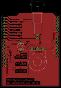

The purpose of this article is to make a board with a R2R Ladder network to convert the signal in a byte (8 bits) format into a analog signal (with varying voltages between zero volts (GND) and supply voltage (VDD)).
First you´ll need to download the PCB files and make a printed circuit board shield (use your own method) and the plug this shield into Intel Edison arduino compatible breakout board.
