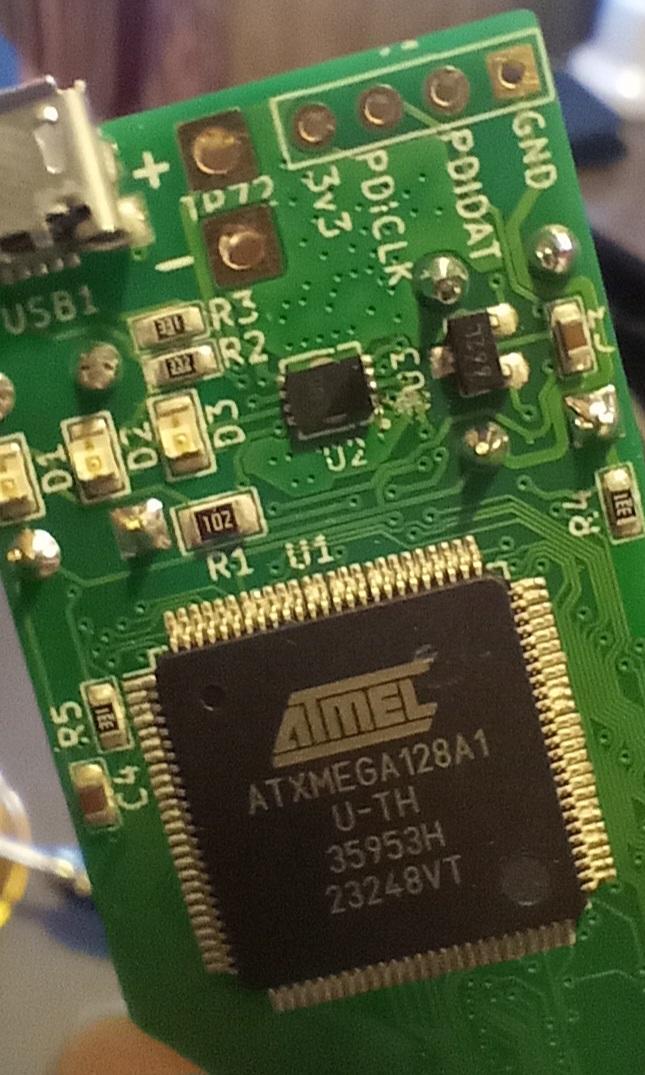

When you have received the assembled circuit boards, verify that the surface plating on the pads without components is correct. It should look like gold. If it's silvery, you've got a problem.
At long last, you are ready to begin the work on your end. Soak the boards in distilled water for 10 minutes, gently scrub them with a toothbrush, drain them, and then replace the distilled water. Allow the boards to soak for an hour. Then, gently scrub the boards with a toothbrush and rinse the boards (and container) with distilled water. Set the boards aside on a clean surface and shake any excess water out of the container.

Step 7: I Really Need to Learn Mandarin
This, dear reader, is where these instructions stop being what I thought they would be. I thought to myself, "It's just a straightforward set of instructions! I've thoroughly tested this design! What could possibly go wrong?" But. Reality makes fools of us all. The best-laid plans of mice and men, and all that.
My reading comprehension of Mandarin is exceedingly limited. I've learned that 光 (guāng) means light, that 红外 (hóngwài) means infrared, and that 红光 (hóng guāng) means red light -- as in a red LED, not a stoplight. I've concluded that the name I'll write under -- if ever I get to the point of being able to translate what I've made into Mandarin -- would be 汞光 (gǒng guāng), literally "mercury light". I'm sure you're shocked.
In any case, the point I'm driving at here is that I designed and initially tested this circuit with the CN3065 battery charge controller, which is since no longer in production. The fabrication facility suggested CN3166 as a replacement, which is pin-for-pin compatible and fits on the same footprint. "Sounds great!", I said, having skimmed the supplied CN3166 datasheet, which -- I might mention -- was in Mandarin. Come to now, I am testing the boards, and... and the charge function doesn't work. A -mere- seven hours and twenty minutes of troubleshooting later, I have found the difficulty! In CN3065 (original design), you ground the TEMP pin to tell the chip to ignore the temperature sense function. In CN3166, the TEMP pin must be connected to ground through a fixed 10kOhm resistor. Just imagine my surprise, joy, and wonder at this revelation!

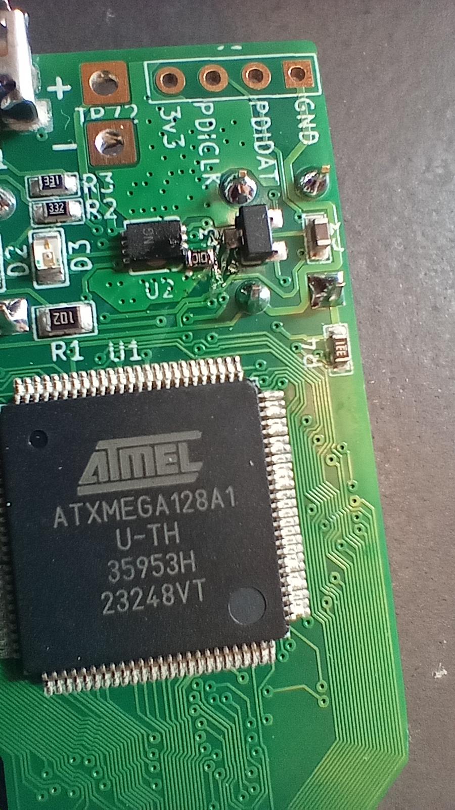

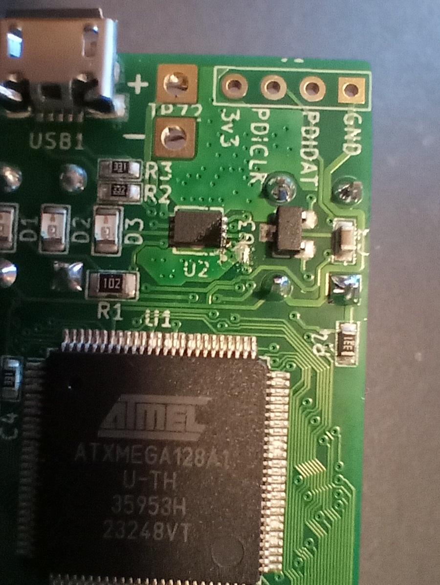

Step 8: The Land of Tweezers and Razor Blades
This step is included merely in the interest of completeness, or, perhaps, amusement. You should not need to follow the instructions in this step unless for some reason you have chosen to build the device based on the files in the "PoNS_deprecated" folder, in which case you must also remember that the ordering system will note that 2 parts "need to be checked manually". Purchase links must be pasted in next to each.
U3: https://www.digikey.com/en/products/detail/torex-semiconductor-ltd/XC6206P332MR-G/7386004
U2: https://jlcpcb.com/partdetail/ShangHai_ConsonanceElec-CN3166/C7435233
Fixing the problem identified in the previous step requires cutting a trace and adding a fixed 10kOhm resistor in series with the TEMP pin (pin 1) on the CN3166. This involves very careful work with a razor blade -- first to cut the trace itself, and then to scrape away the solder resist on the adjacent ground trace. Next, the soldering iron must be employed in order to tin one terminal of an 0603 (1608 metric) 10kOhm resistor, which is then held with tweezers against pin 1 of the CN3166. Applying the soldering iron reflows the solder and forms a connection between one side of the resistor and pin 1 of the CN3166. The other side of the resistor can then be soldered to the copper exposed on the adjacent ground trace (see pictures). You will not have to do this, as I have since updated the production files to include the required part.
